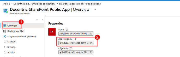

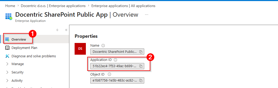

- After registration, copy the Application (client) ID from the Overview page - you will need this later.

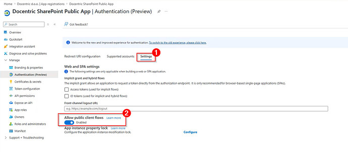

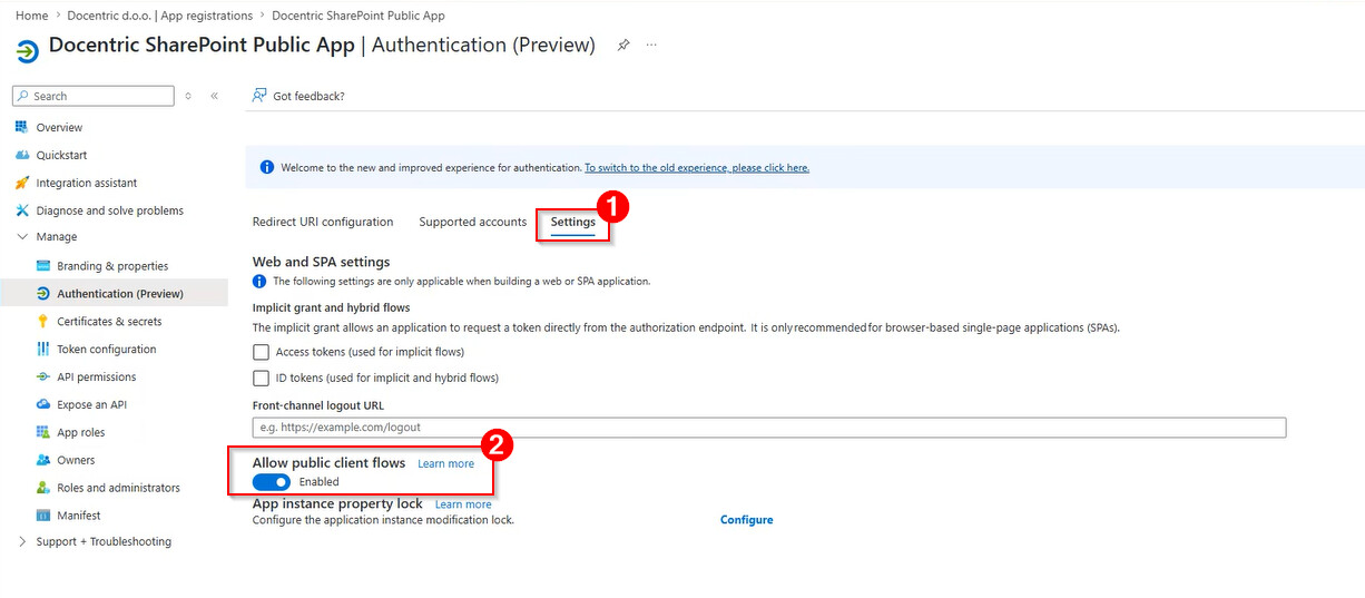

- In your app registration, go to Authentication.
- Open the Settings tab.
- Under Allow public client flows, set the toggle to Yes.
- Click Save.
Why is this required? ROPC does not use a redirect URI or a client secret. It relies on the user’s username and password being passed directly. This is only permitted for public client applications.

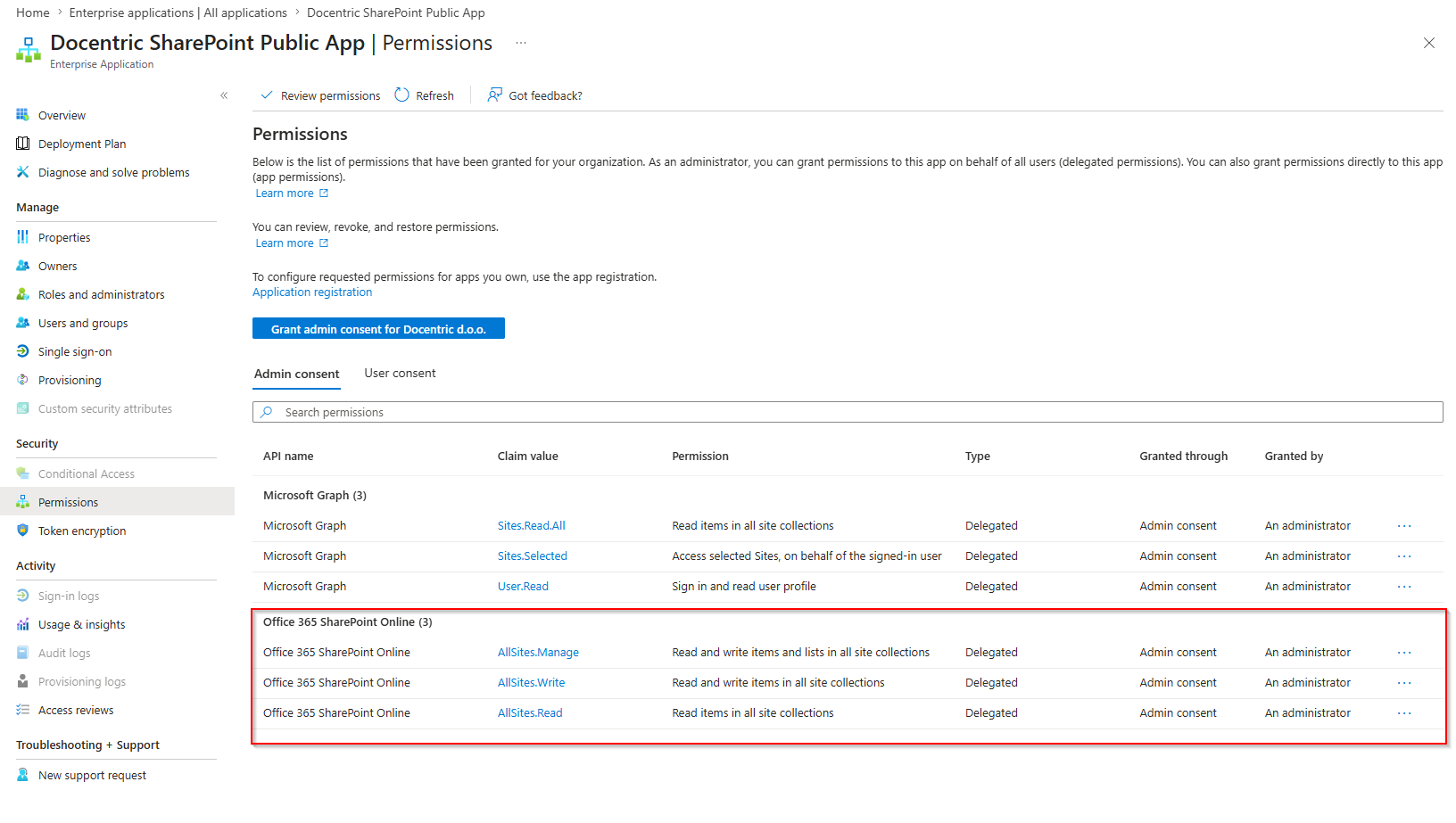

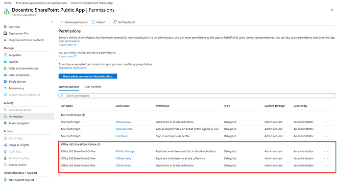

Step 3 - Grant API Permissions
Your application needs delegated permissions on the Office 365 SharePoint Online API.

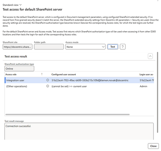

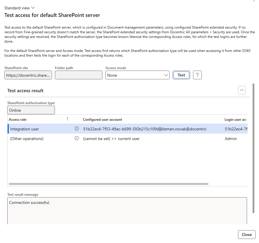

Step 5 - Verify the Connection and test login
After saving the configuration, test the SharePoint connection from within Docentric AX Parameters > Security > SharePoint extended security > Test access for > Default SharePoint server.
If the test fails, verify:
- Admin consent was granted for all three permissions.
- The Allow public client flows toggle is enabled.
- The correct Application (client) ID was copied.
- The application is registered in the same Entra ID tenant as your SharePoint Online site.
- The user account used has access to the SharePoint site collection.
