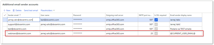

There are different users who create purchase orders in D365, but all purchase order confirmations should be sent from the general info@example.com account (a shared mailbox address) instead of the user who creates the confirmation. The info-account is a shared 365 account that has no login credentials to log in. This means that we cannot specify the username and password in the emailing parameters as required.
We also tried to add the accounts in the Docentric parameters in the form setup, and this results in a mail sent from the info-account as expected, but upon replying to it we noticed that it is still sent to the default user’s email account.

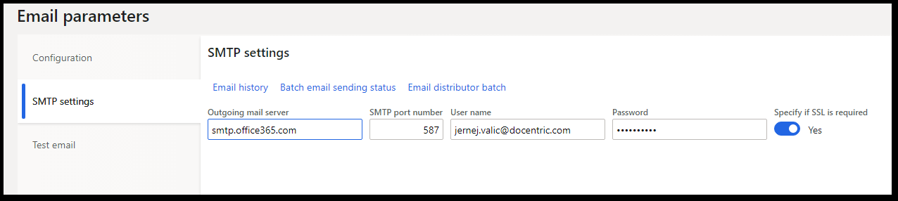

You should use the credentials of a user who has the permissions and access to this shared mailbox that you are trying to send the e-mail with. In other words, you should set a User name and Password of an account that is allowed to send e-mail (e.g. from Outlook) from this shared mailbox .
Here is an example of a shared mailbox (webinars@docentric.com) that I can use to send the emails from D365FO.
You should, of course, set a different Sender email and Email sender display name in your case - the way I understand you the general company email account should be used?

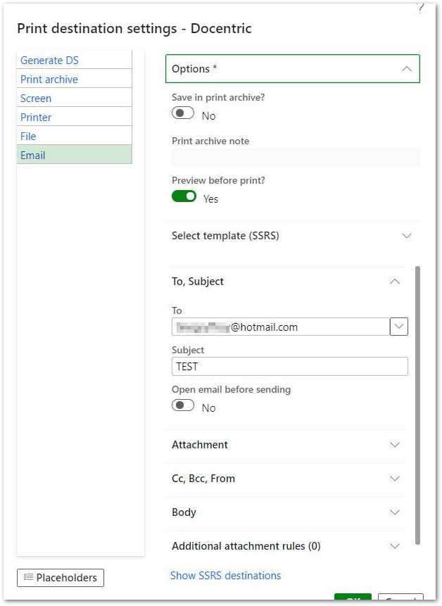

Set the Email print destination for a report of your choice and use the shared mailbox address in the From field. To check whether the From field is resolved as expected when you run the report, enable also either the Preview before print or Open email before sending option.

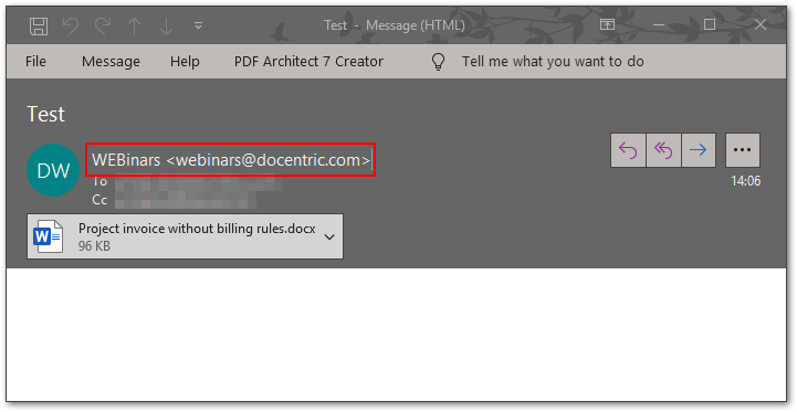

When the report is generated, you will have the option to download the email. We can now check the Email sender display name (WEBinars) and Sender email (webinars@docentric.com) values in the downloaded file:

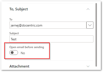

But, before further testing of the outgoing emails, please disable the option to Open email before sending:
Important : Do not try to actually send the downloaded e-mail file (.eml) from Outlook. I will not go into detail, but we have already encountered some problems related to the way Outlook/Exchange handles such generated emails. Just print the report again and check whether you get it with a From field resolved as expected. We recommend that you test the behaviour for an external e-mail address as well.

I do not have the field Sender email available in the additional email sender accounts table. Is this because we are using the Free version of Docentric?

You will then set it as the default sending account, while the shared email account should be deleted from the additional email sender account table.

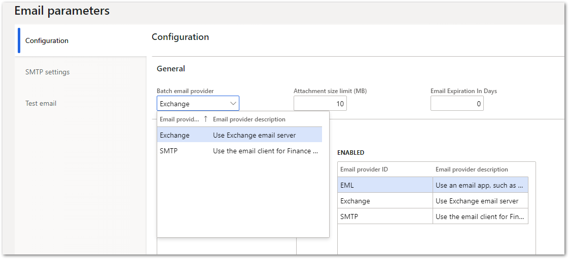

Batch email provider
You have the option to set either Exchange (supposedly no other settings will be needed, but you should check this with your network administrator):
… or SMTP, where the email from the SMTP settings should have the access to the shared mailbox:
If you now head to Print destination settings and simply enter the shared mailbox account in the From field, an email should generate which you can first download as EML (Open before sending) in order to check the From address, then try to send it directly from D365FO without downloading it.

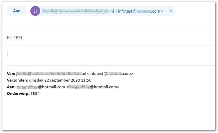

Thank you for your reply. I tried to set it up like you indicated in your mail but the mail is not correct:
When I do a reply it is sent to my personal email and not to ‘infotest@company.com’
