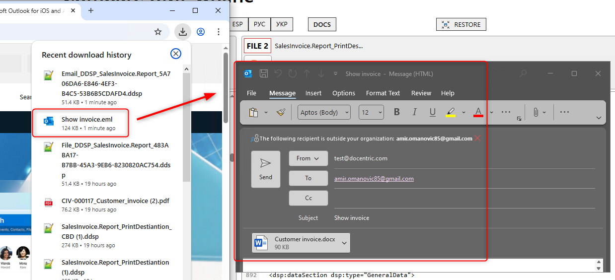

We click on any Purchase order confirmation Journal go to the next page. And then click on “Print/Preview” → “Use print management”, it actually first open an outlook email pop-up which is having all the information. like sender email, recipient email (from Vendor master setup), subject and body, then once we click on the send button and it sends the email.
We usually click on the Download email button in the preview to download the EML file via our browser.

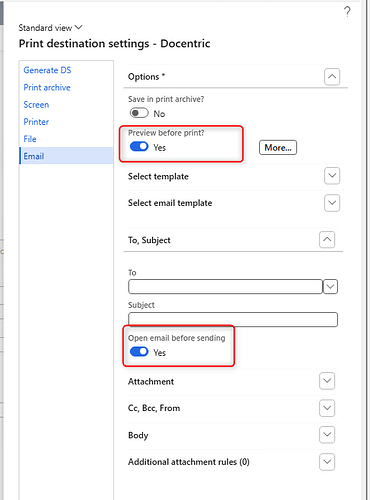

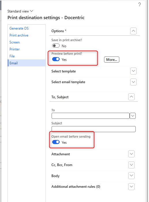

In the Email print destination, you’ll find two flags:
Open email before sending – downloads the .eml file so you can open it in your email client.

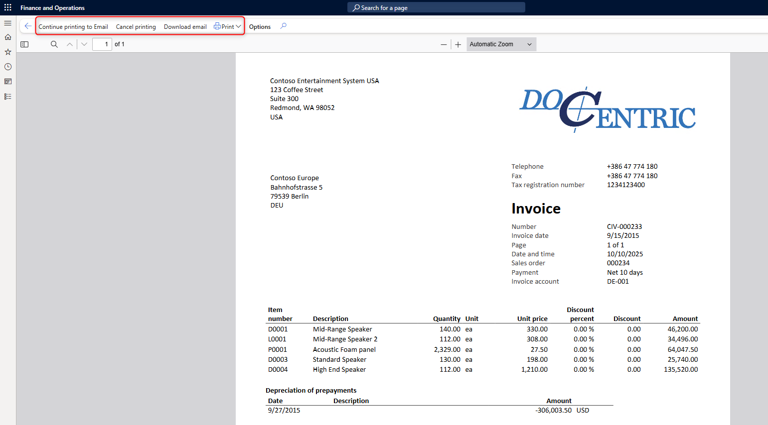

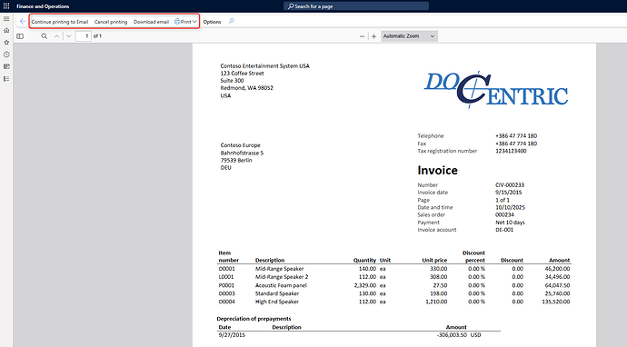

Preview before print? – opens the report in preview mode. From there, you can review it and click Continue to send, which will then send the email automatically.
If you don’t want to use these options anymore, simply disable the flags.
It’s up to you to decide what works best. Please set your print destination according to your needs.

Hi @AnujR,
That is done in the Docentric Email print destination. Please see the first image in my last reply in this forum thread.
