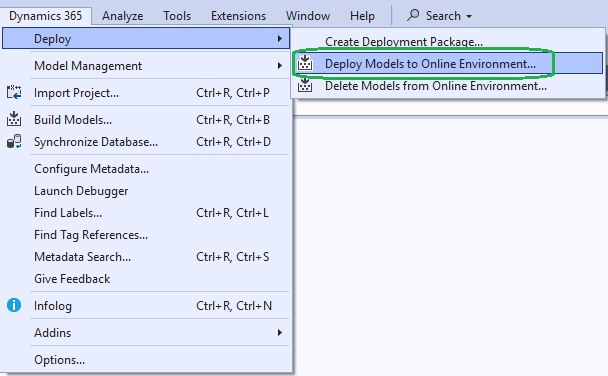

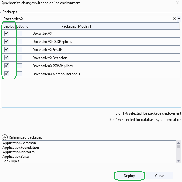

Instead of syncing when deploying the models to the UDE environment, just do the following:
  1. First deploy just the code of the models you are updating:

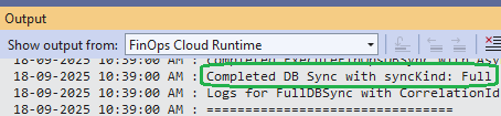

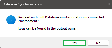

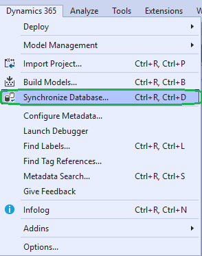

  2. Then, after the deployment is complete, do a full sync of the database:
The database synchronization should complete successfully this time:
