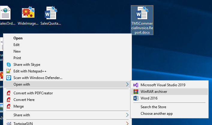

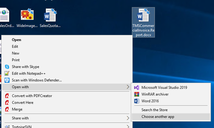

  1. Open the replica file as an archive (if the replica’s already open in Word, you’ll get an error):

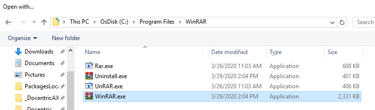

  • Side note If you don’t have WinRAR in the list, you can add it like this:
    Click “Choose another app” → “More apps ↓” → “Look for another app on this PC” and then select the WinRAR.exe:

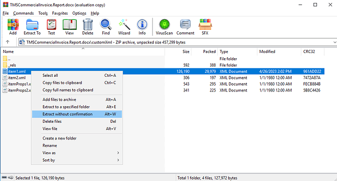

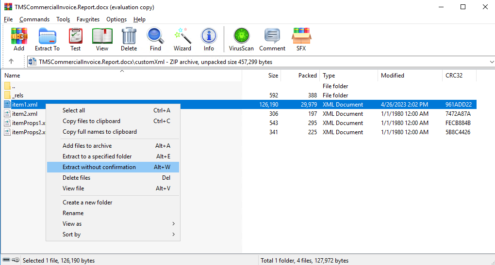

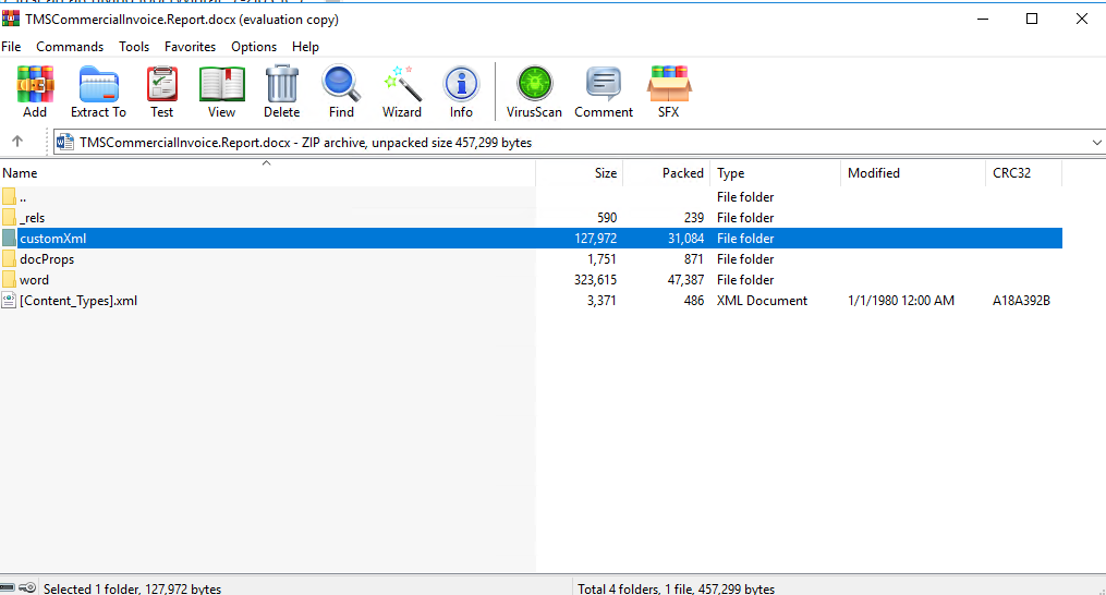

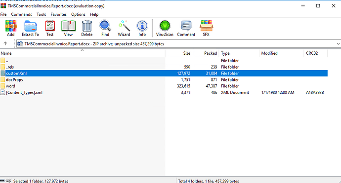

  1. Navigate to the customXml directory:

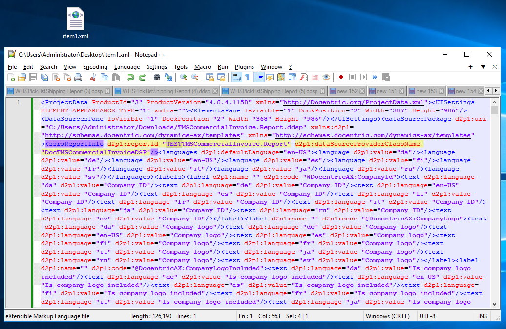

  2. Extract the item1.xml file, in most cases this is the DDSP, but it doesn’t have to be:
  3. Open the item1.xml file in your editor of choice and edit it:

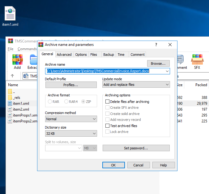

  4. Drag and drop the item1.xml file back into the archive and confirm the dialog:
  5. The changes made in the DDSP will now be visible on the replica:

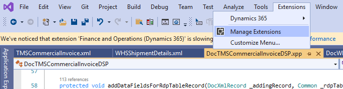

Installing the extension

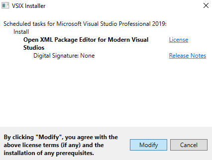

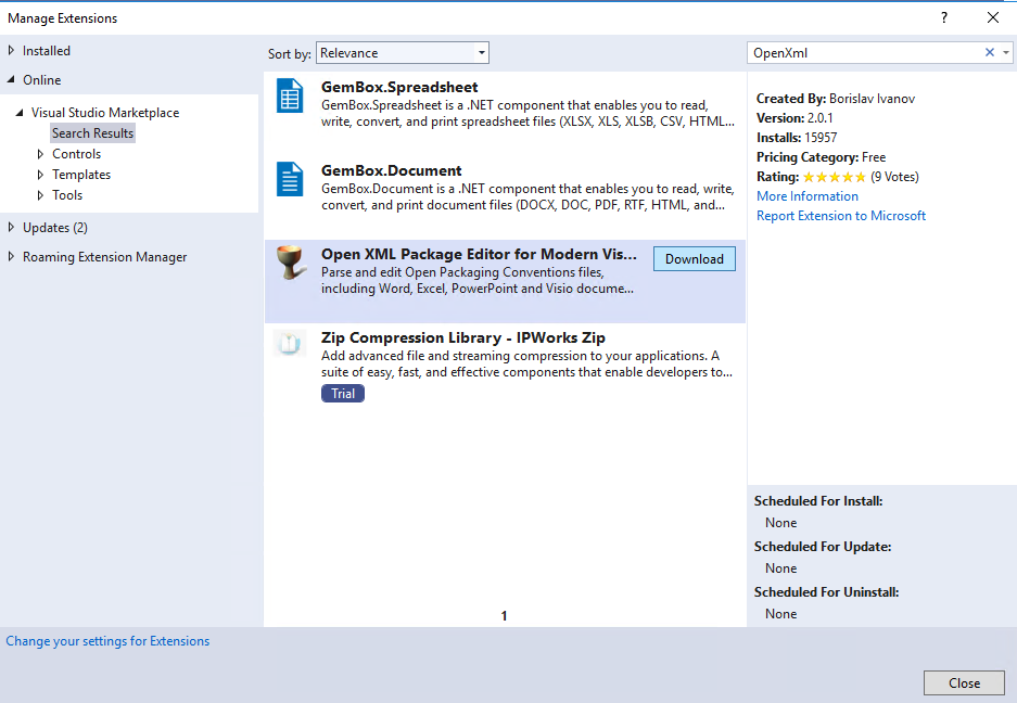

  1. Open extension menu:
  2. Search for OpenXML and click download:

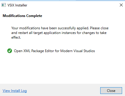

  3. Close Visual studio and this menu should pop up. Click on modify:
  4. The extension is installed and you can now start Visual Studio again:

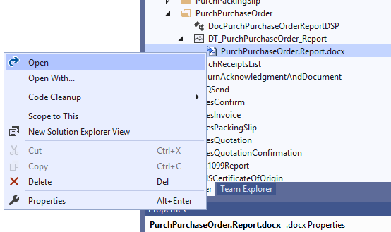

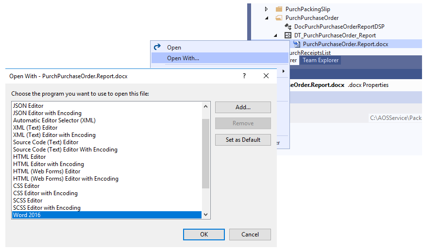

  1. Now when we try to open a replica, instead of opening Word, it will open its contents:
    Side note, if we want to open the replica in Word, we can still do that like this:

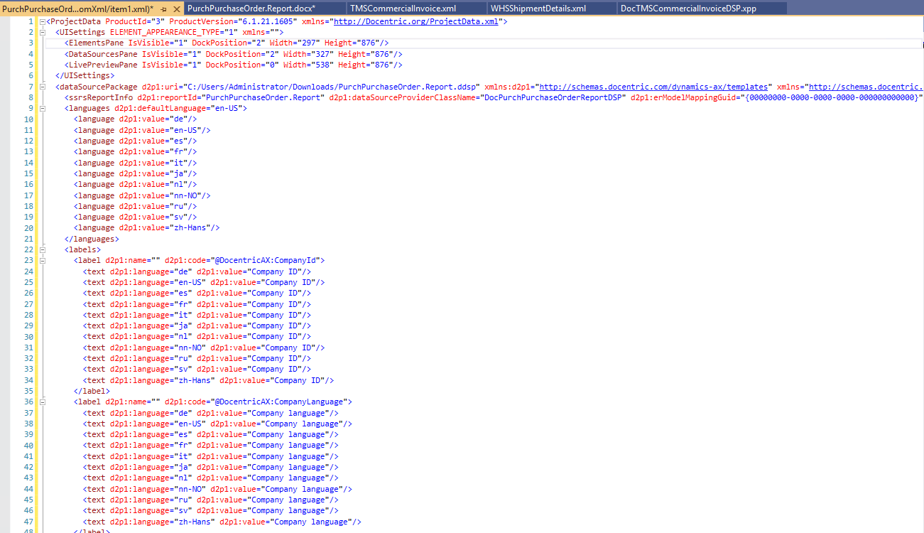

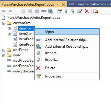

  2. Inside the contents of the file we can then find and open the DDSP, it will be named something like item1.xml (it doesn’t have to be the first one though):

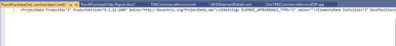

  3. This will open the DDSP as an unformatted XML file:

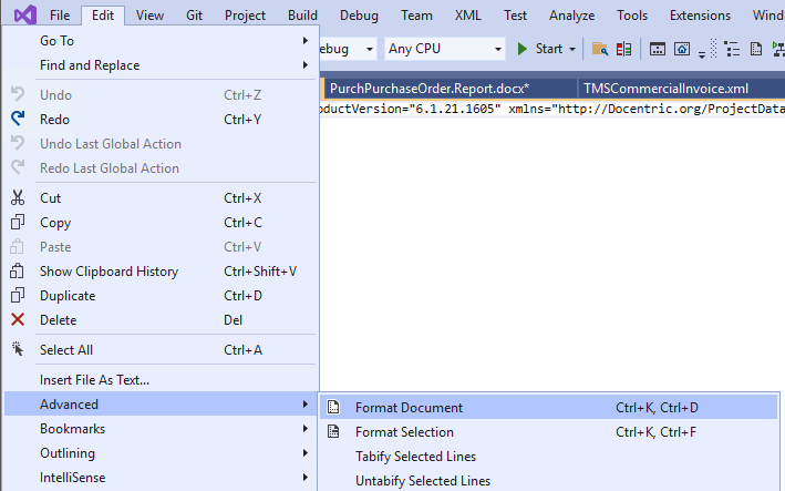

  4. To make it easier to work with we can format it, like so:

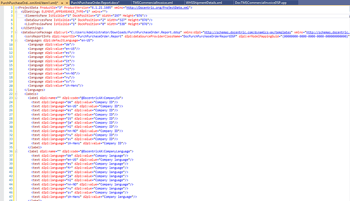

  5. We can now edit the DDSP and any changes made here will also be visible on the replica itself:
