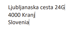

Let’s say that we are looking at a generated report, and we noticed that the postal address field contains a vertical bar character (|) at the end of each address line.

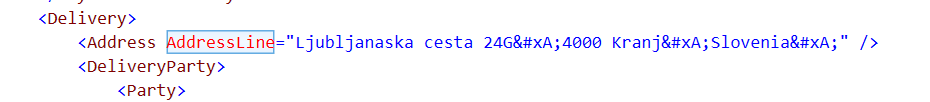

The Field tagging element that shows the postal address is bound to the AddressLine field.
However, looking at the value of AddressLine in the Data source pane, we don’t see any vertical bars, only line-break characters (the ‘
’ part is an encoded line feed).

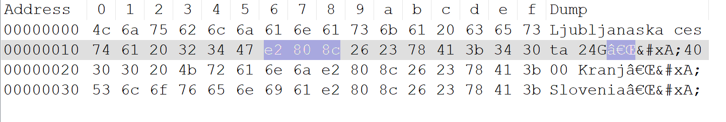

Now, to inspect the data source more closely, we can view it inside a tool such as the Hex Editor plugin in Notepad++, which allows you to view a file at the raw byte level.
When you view the content of the AddressLine field with the plugin, you find the following hexadecimal sequence after the ‘Ljubljanska cesta’ part of the string:
e2 80 8c
This hexadecimal sequence represents the UTF-8 encoding of Unicode character U+200C, the Zero Width Non-Joiner (ZWNJ).
Basically, it is an invisible character that tells text-rendering software not to join two characters together. This character is invisible in Word, but the Docentric Live Preview and PDF output render it as a vertical bar when it appears before a line break.
Removing this part from the data makes the vertical bar disappear.
That means that this character is indeed responsible for showing the vertical bar in the address, even though we cannot see it directly when looking at the value of AddressLine.
