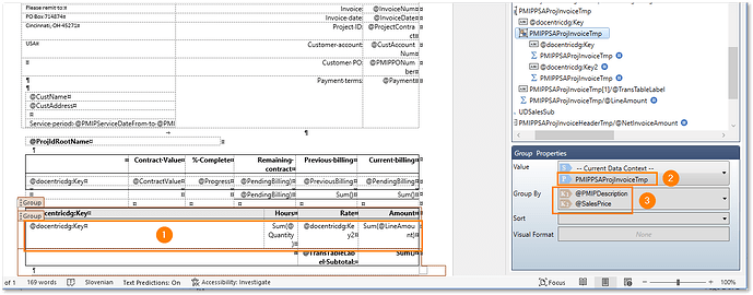

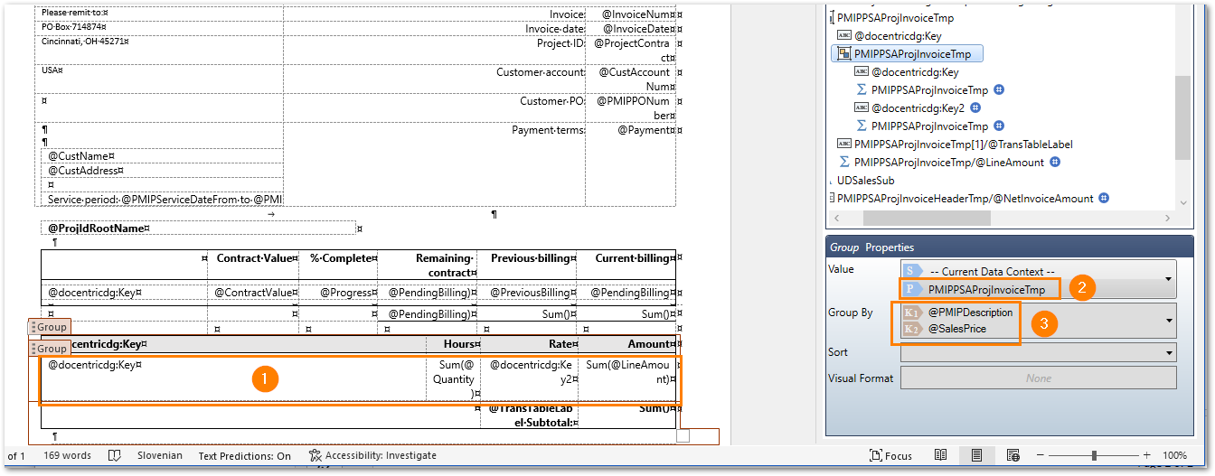

I first removed your second Group tagging element, because it occupied only one cell. Then I selected the entire row (see #1 in the screenshot below) and set a group as indicated by #2 and #3 in the screenshot. If you open the Group By settings you will see, that you simply add all the fields that you want in a group.

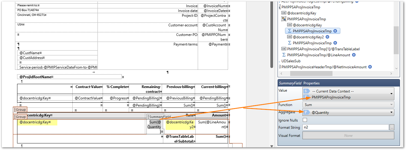

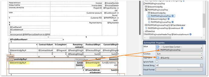

Then I added Field tagging elements. Description and Rate use the @docentricdg:Key and @docentricdg:Key2. Hours and Amount use SummaryField as shown below:
