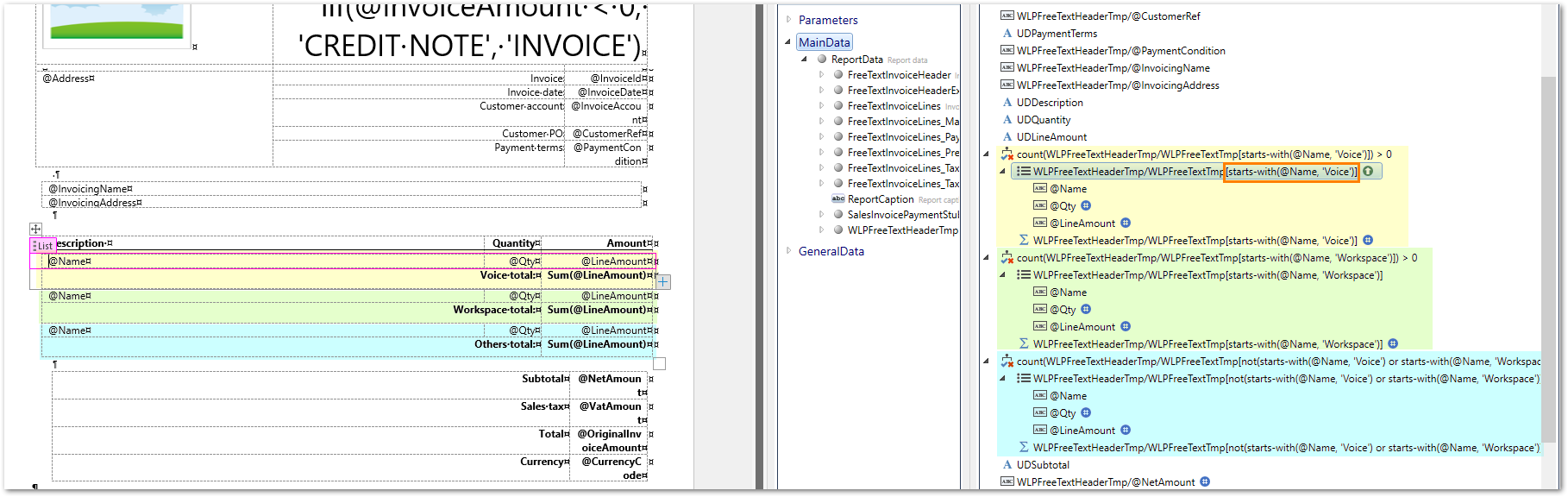

Hi, we’re revisiting this.
The ask changed to list all lines where WLPFreeTextHeaderTmp/WLPFreeTextTmp/@Name contains the words “Voice” and “Workspace” separately, each with subtotals. So assuming this will be two separate tables, I used a list with an iif function to only display the “Voice” lines. This however doesn’t work well with the Quantity or Amount fields as it’s picked up as a string and not a number. Is there a different way to separate the lines based on what the field starts with?
I attached a more recent ddsp and template.
WLPFreeTextInvoiceGC.Report (21).ddsp (256.1 KB)
Google Workspace & Voice FTI edit.docx (73.3 KB)
Hi Vicky,
I modified the template to meet your requirements. I applied three tables where I used List tagging element and filtered the content to just get the values I want. The first list only shows names which start with “Voice”, the second list only shows names which start with “Workspace” and the third list shows everything else. I applied conditional logic on each of the list, so it only shows if it contains some data.
The trick is in the filter (see the part, marked with orange rectangle above). The same filter is applied in the If tagging element and in SummaryField tagging element, which calculates the LineAmount sum of the filtered records.
