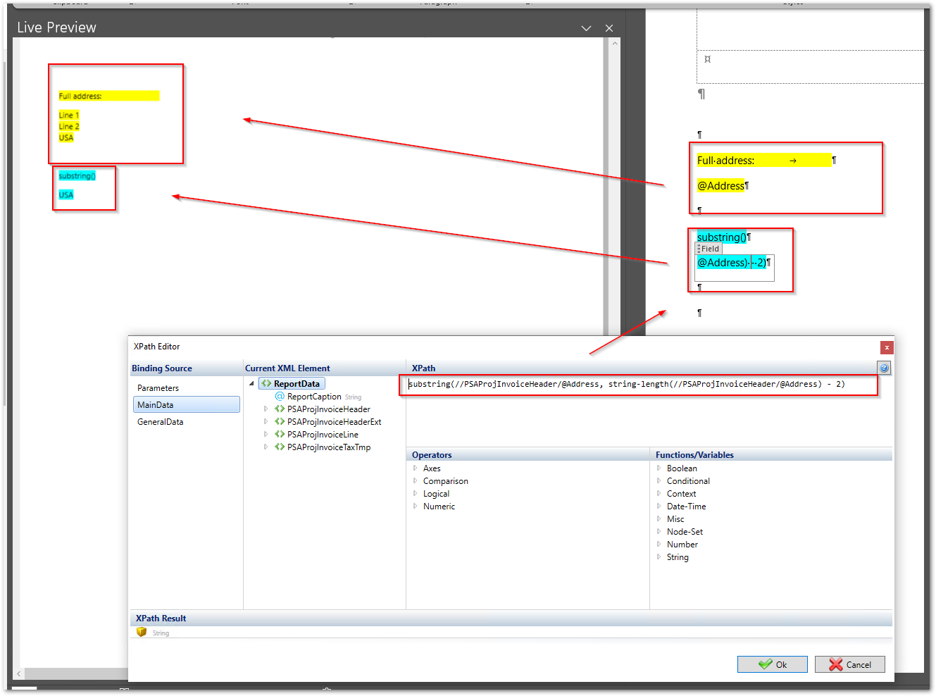

We have an address field and want to essentially take the country code to utilize in our TMSCommercialInvoice.Report for the country of origin.
Is there a function to pull out only the last 3 values of this field?
Hi @spare,
Welcome to the forum!
There are several ways to solve this using an XPath 1.0 expression.
If you want to always extract the last 3 characters, you can use a combination of the substring() and string-length() functions in XPath. It would look something like this:
substring(//PSAProjInvoiceHeader/@Address, string-length(//PSAProjInvoiceHeader/@Address) - 2)

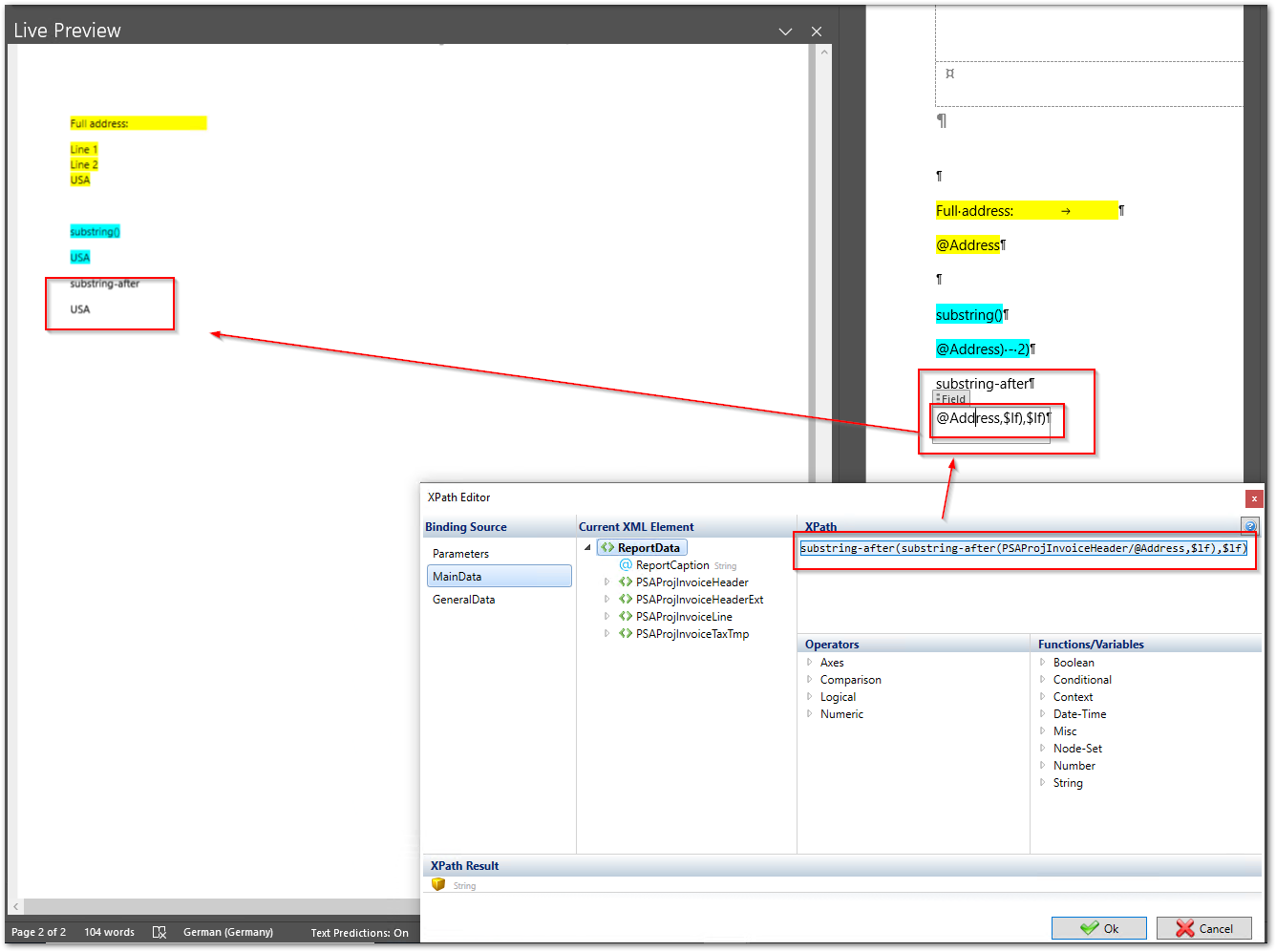

A more flexible approach might be to use the substring-after() XPath 1.0 function to extract all the values before the last newline character. Since the address contains line feeds, this will help determine when the address should move to a new line, ensuring the correct format. This method isn’t limited to just 3 characters; it could work with any number of characters and will still function correctly.
substring-after(substring-after(PSAProjInvoiceHeader/@Address,$lf),$lf)
Try it out and let me know how it goes.
Thank you for the explanation - this worked perfectly!
