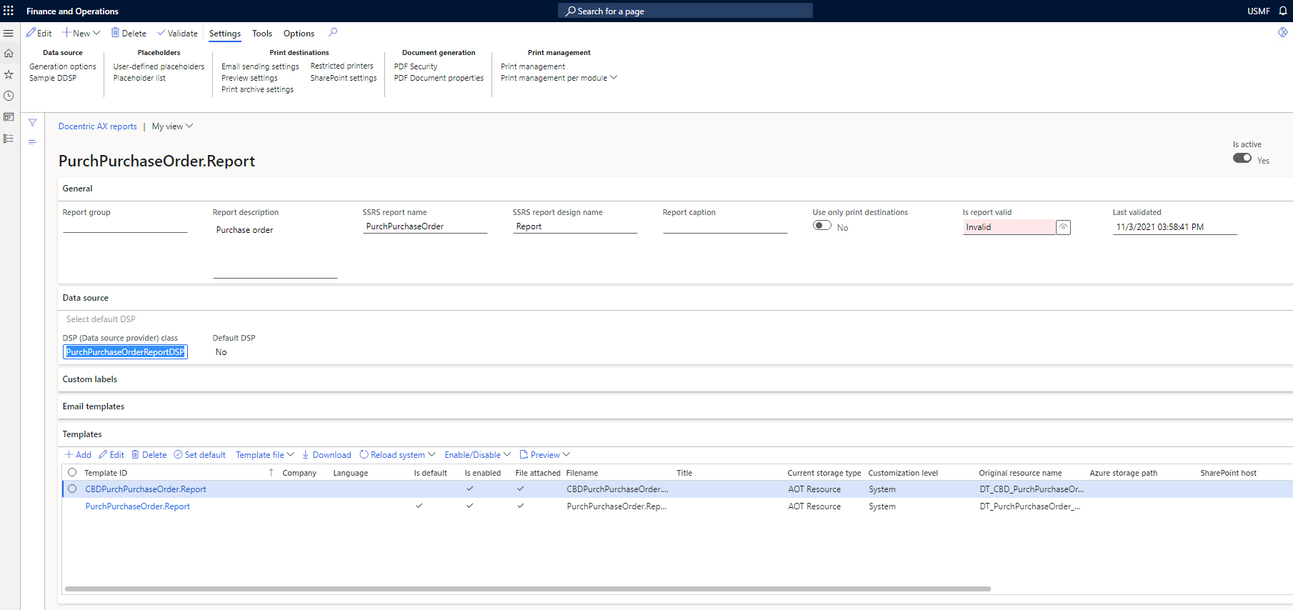

Which DSP class are you using? Could you go to Docentric report setup and check?
Did you do some changes maybe in DSP class that you are using? For testing purposes you can click on button Select default DSP and test if you have all data with this generic class.
So the class that I believe I want is
DocPurchPurchaseOrderReportDSP
but I clicked Edit and then Select default DSP and it changed to
DocDataSourceProviderSrsReporting
I’m new to Docentric so I’m still trying to figure out how this all works. I’m also not sure how I test if I have all the data when clicking on Select default DSP
After you changed the class, you can run report again and get another DDSP file, after that you could load it to Word and check if you see all extension fields.
As you already have ddsp file I guess that you have setup to get DDSP on report execution. If not, just let us know, we will help with that.
