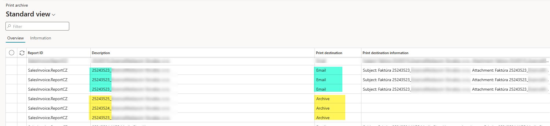

I am invoice posting multiple sales order (not in batch). The system creates as many EML fields for the first invoice so many orders I am posting. Instead of one file for each invoice.

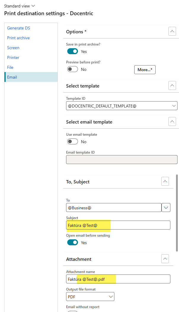

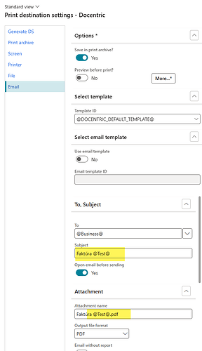

I have print destination set to Email with an option Open email before sending Yes. For the subject and attachment name I have user defined variable set as @Test@. The variable is defined as SalesInvoiceLocHeaderExt/@InvoiceId.
It is interesting that for the Print archive this variable works well.

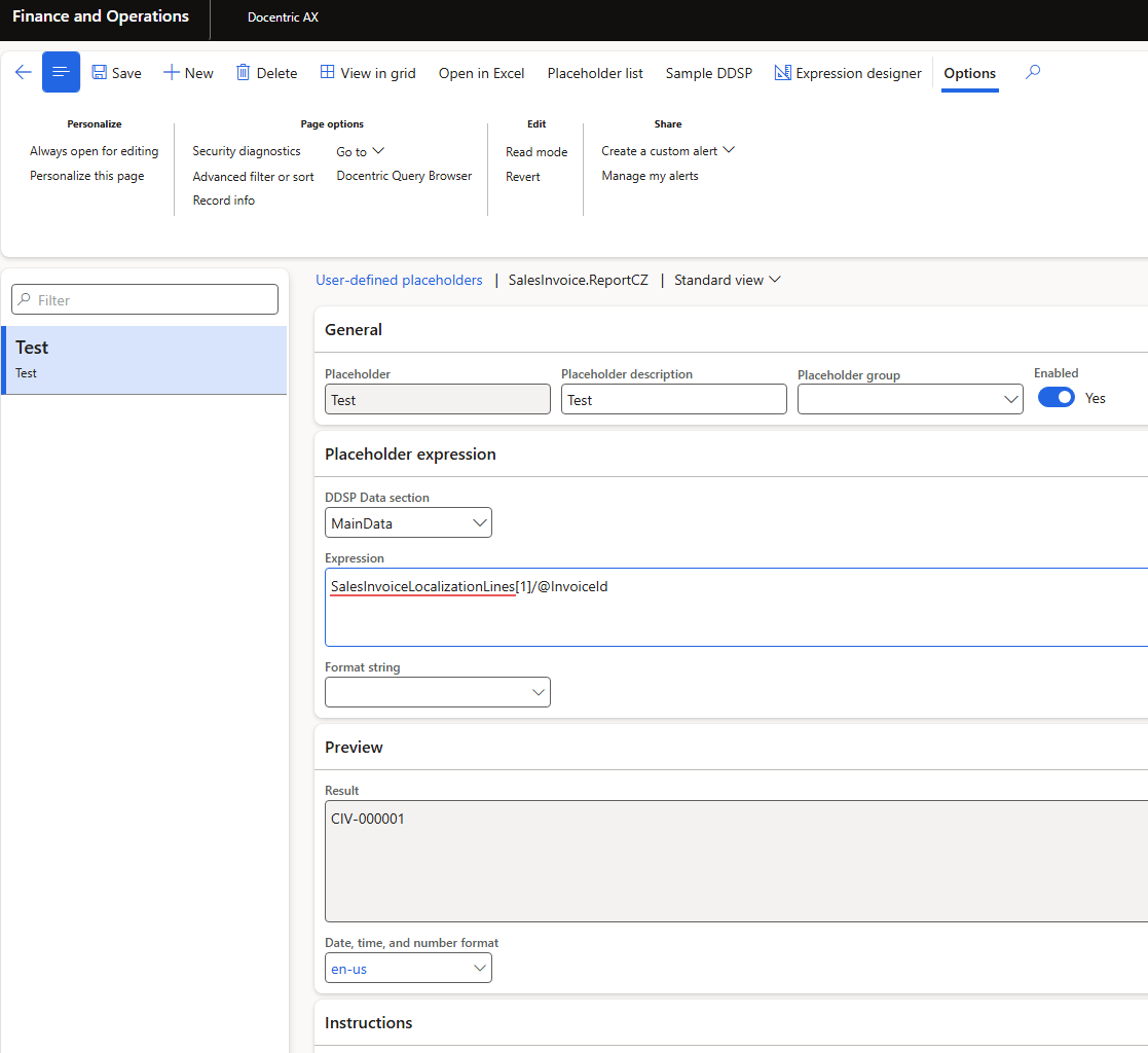

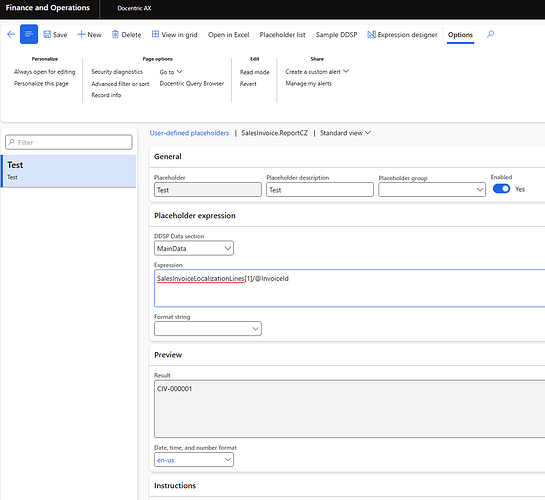

I see you’re using SalesInvoice.ReportCZ, so it might be worth checking if the following placeholder value works for you:
SalesInvoiceLocalizationLines[1]/@InvoiceId
Unfortunatelly the label SalesInvoiceLocalizationLines[1]/@InvoiceId does not provide any result (Preview result: INVALID_EXPRESSION (No results.))

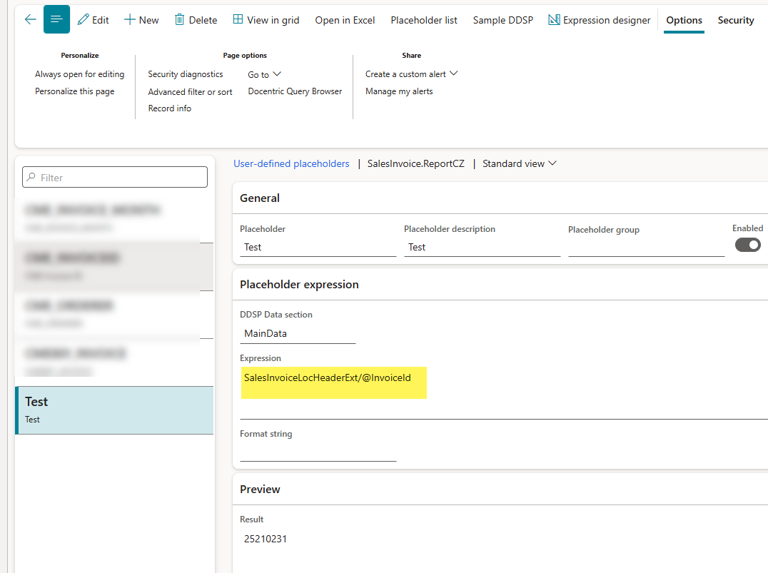

The placeholder I am using works on the report where it represents the invoice number and also works properly for the print archive. The Print archive is created correctly unlike the email.

I have tried to use the email template instead of the email body specification in the print management, but there is no difference.
