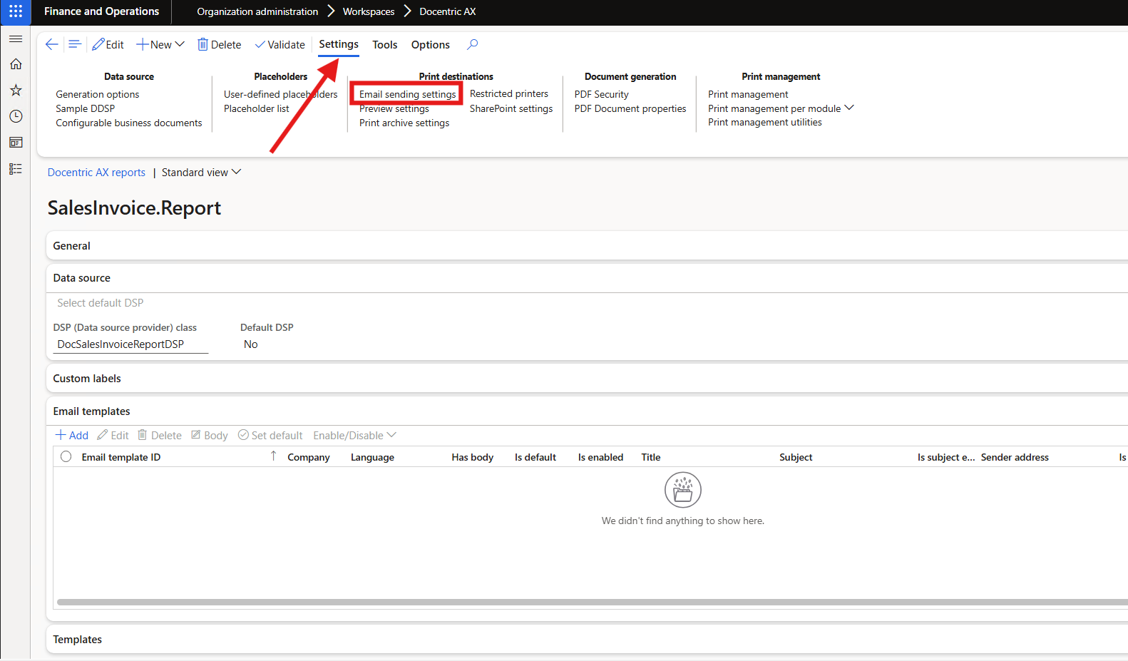

Hi
I am new to Docentric and trying to use free version of 3.5.1.0 with D365 F&O.
Docentric is installed on D365 F&O server however I could not see the Docentric Settings Tab for Email Configuration. Though I can find Docentric Parameters in the system for set up. Please suggest what is missing here. Thank you.
Hi @GKS ,
First of all, welcome to the Docentric forum!

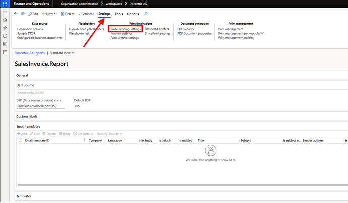

You can access Email sending settings for each report by navigating to Report setup form, selecting the report you want to configure, Click Settings tab in the toolbar and click Email sending settings within Print destination section
Let me know if this is what you were trying to achieve.
