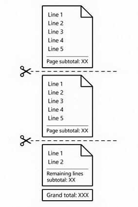

But now, let’s say we want something a bit different, we want to display the sum total at the end of each page.

Then we check if we’ve reached the end of a page. To do this, we use the modulo operator — we divide the current line number by the maximum number of lines allowed on a page. If the result has no remainder, that means we’ve reached the last line on the page.
At that point, we display the total and insert a page break.
But here’s the catch: we also need to reset the running total right after showing it. This way, each page starts with a clean total, and what we get is a separate sum for every page.
This approach gives you a page-by-page breakdown of totals, perfect for long documents where each page needs its own summary.

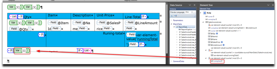

Step 9: Add reset to running totals
After the page break, and still inside the same IF tagging element, insert a new Var tagging element.
Set the Name to runningTotal and the Value to 0 .
This will reset the total so the next page starts fresh.
Now let’s preview the report. Instead of a running total that increases across pages, you should now see the sum total per page displayed at the bottom of each page.
