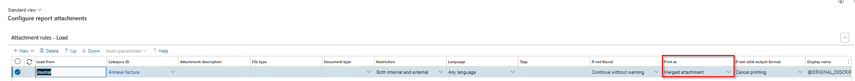

We deployed Docentric 3.5.1 last week and highlighted the new feature for merging PDF attachments into a single document with the default print destination setup.

Can you please send us a screenshot of the relevant settings you mentioned so we get a better idea of your scenario and what could be causing this issue?

it’s the new merging attachment feature of 3.5.1 :
