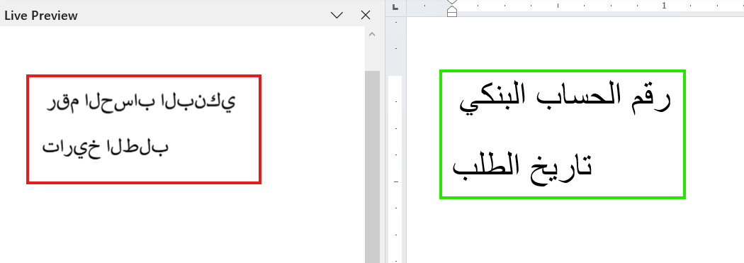

Docentric Word document generation works correctly for Arabic Unicode character set but not for Arabic Presentation Forms-A and Arabic Presentation Forms-B Unicode character sets.
When PDF generation is concerned with Live preview, PDF Preview in Docentric designer and generating PDF from D365FO, the Arabic text is incorrectly shown in LTR (Left-To-Right) mode for all character sets:
For preview purposes during Design-time, we recommend using Word preview to be able to view the correct RTL mode with character connections.
For printing from D365FO on Tier 2+ environments, you can call Office conversion services to generate Arabic text in PDF correctly.

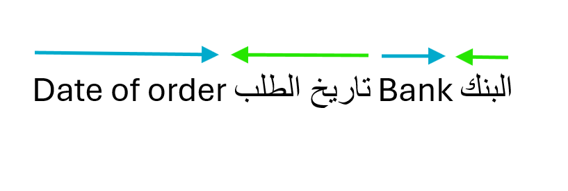

Bidirectional text
When combining RTL (Right-To-Left) with LTR (Left-To-Right) in the same text, certain standard behaviour is observed which is referred to as Bidirectional text. According to Microsoft documentation, the actual text that is presented is never reversed or “mirrored”, meaning that English text is always read LTR while Arabic text is always read RTL. This means that in the following example, the text written in English follows its LTR direction while the text in the same sentence written in Arabic is written in RTL:
You can read more in the referenced Microsoft documentation: Right-to-left language support and bidirectional text - Finance & Operations | Dynamics 365 | Microsoft Learn
