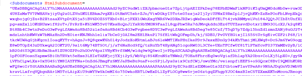

This is how the binary content will look like in the data-source:
