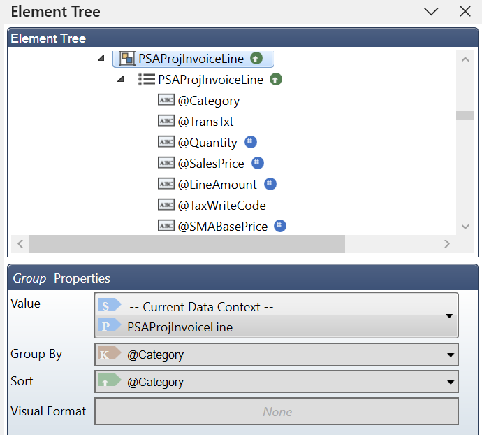

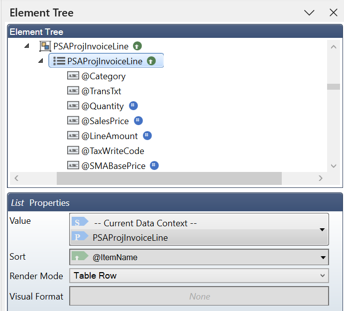

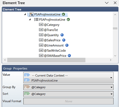

In this particular example, the template included a Group tagging element. Inside this group, there was a List tagging element traversing through all the elements of the group, sorted by the field Item name.
That means that for every group created, the sorting is done inside the List tagging element for each group.

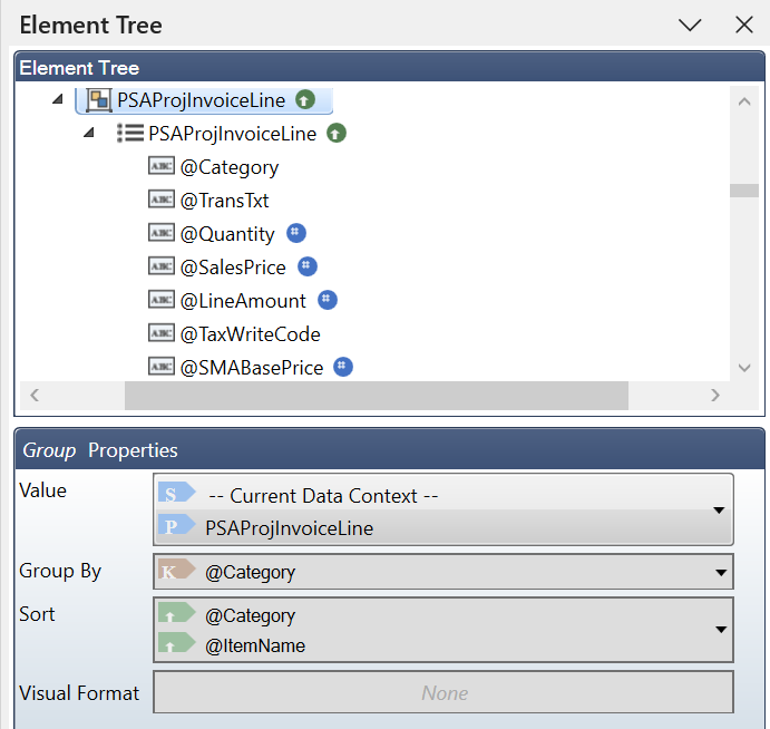

Now, let’s make just one small improvement here – by sorting the Group tagging element by the Item name field in addition to the already existing Category field. This ensures the records are pre-sorted during grouping, so by the time they’re displayed in the List tagging element, the items will already be ordered, resulting in faster rendering.
After this simple modification, the report generation time went down considerably.
