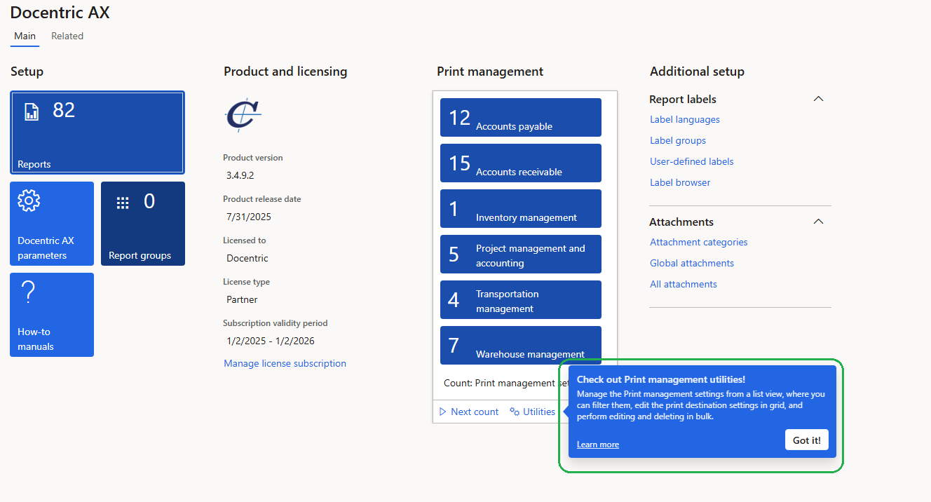

Which will produce the following result:
The SystemNotificationsWhatsNewManager::AddWhatsNewWithActionLink() method should be called when the control that you want the callout to point to is visible.
In most cases, this will be the init() method of a form.
But, if for example the control is on a different tab page, you would have to call the callout method when the pageActivated() method of the control is called.

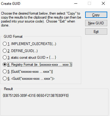

To generate a GUID, you can use Visual Studio’s built-in feature:
