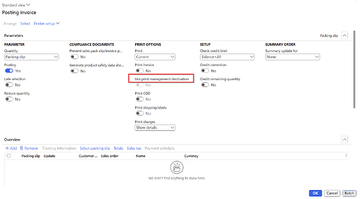

It seems that the batch job parameters were cached from some earlier setup, where Use print management destination was not active.
Solution:
The client solved this by clearing the Use print management destination flag and saving the change, then enabling the flag again.
