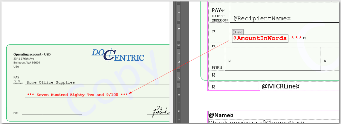

If I understand correctly, you want to implement similar functionality to what is used on the check report:
In that case, using an X++ approach would be the most straightforward solution. There’s a built-in method called Global::numeralsToTxt() that converts numbers to words. You can read more about it here:
:link: https://360dynamics.blogspot.com/2017/09/dynamics-ax-x-code-amount-to-word.html
You can use this method to create a custom data field (e.g., @AmountInWords), which you can then expose and use in your invoice template with Docentric.
To implement this, you’ll need assistance from a developer or your implementation partner.
