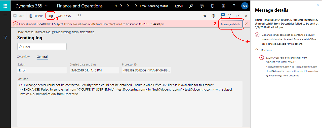

Sending log
Sending log traces sending of outgoing emails stored in Email sending status, done by Docentric email distributor batch.
To view the Sending log of an outgoing email, select a record and click the Sending log button.
The Sending log form shows sending history, with the newest events listed on the top. We can see below how it looks like to have an unsuccessful sending attempt that returned an error, followed by a successful sending of the same email.
You can view a log message in a larger textbox as well as in the form of Infolog on the General tab of the form. Note that the error message itself is much more detailed than when using built-in Email distributor batch.
