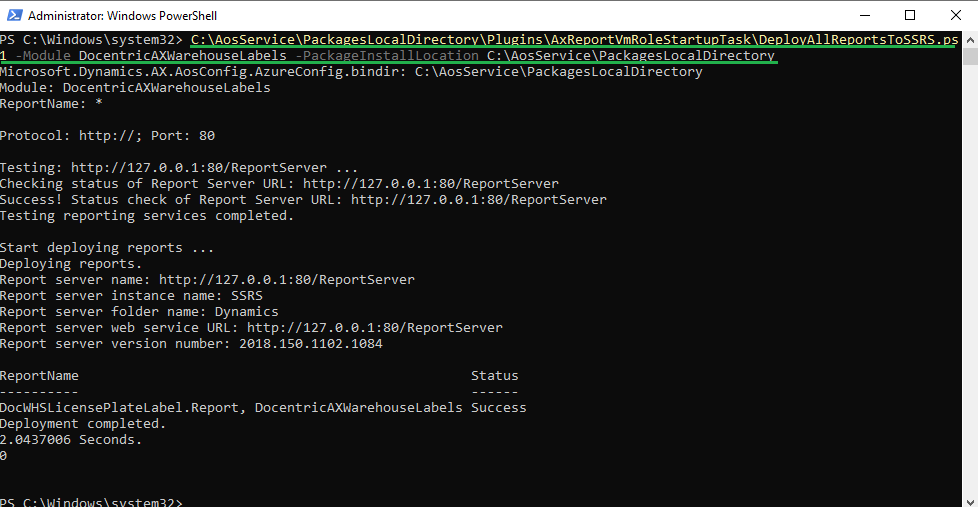

If you’re on a DEV machine, the quickest way to deploy the report is to just run this command in PowerShell:
C:\AosService\PackagesLocalDirectory\Plugins\AxReportVmRoleStartupTask\DeployAllReportsToSSRS.ps1 -Module DocentricAXWarehouseLabels -PackageInstallLocation “C:\AosService\PackagesLocalDirectory”

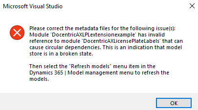

When refreshing models after installing the latest update, you might get this error:
Transcription:
Please correct the metadata files for the following issue(s):
Module ‘DocentricAXLPLextensionexample’ has invalid
reference to module ‘Docentric AX License Plate Labels’ that can
cause circular dependencies. This is an indication that model
store is in a broken state.
Then select the “Refresh models” menu item in the
Dynamics 365 | Model management menu to refresh the
models.
This is most likely because there is a model that is referencing the now obsolete Docentric AX License Plate Labels model. In this example the model is called DocentricAXLPLextensionexample, as can be seen in the first part of the error message.

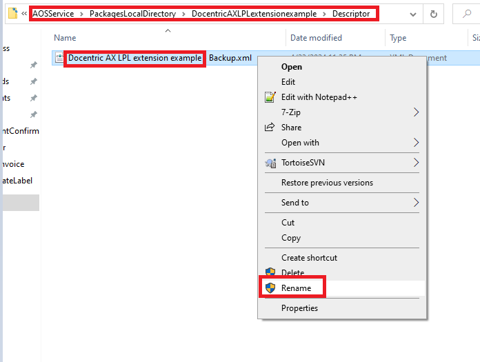

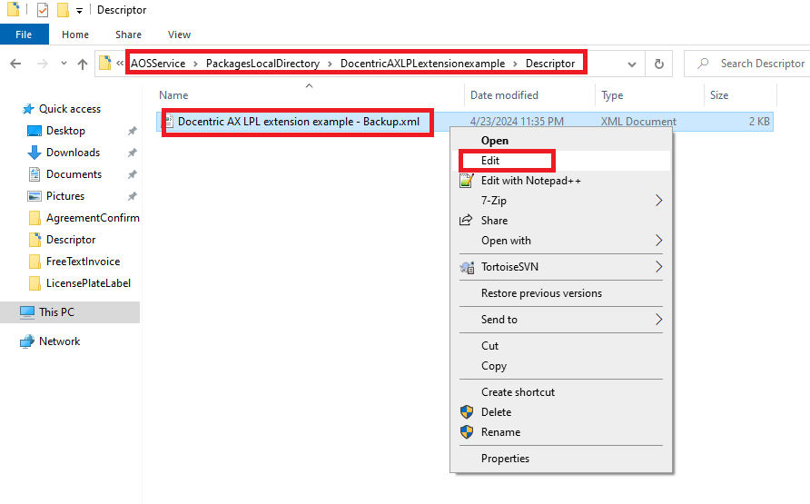

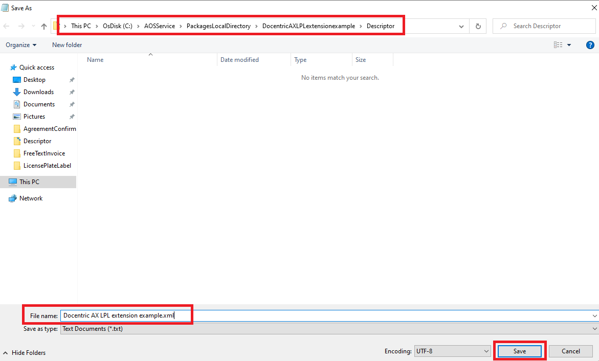

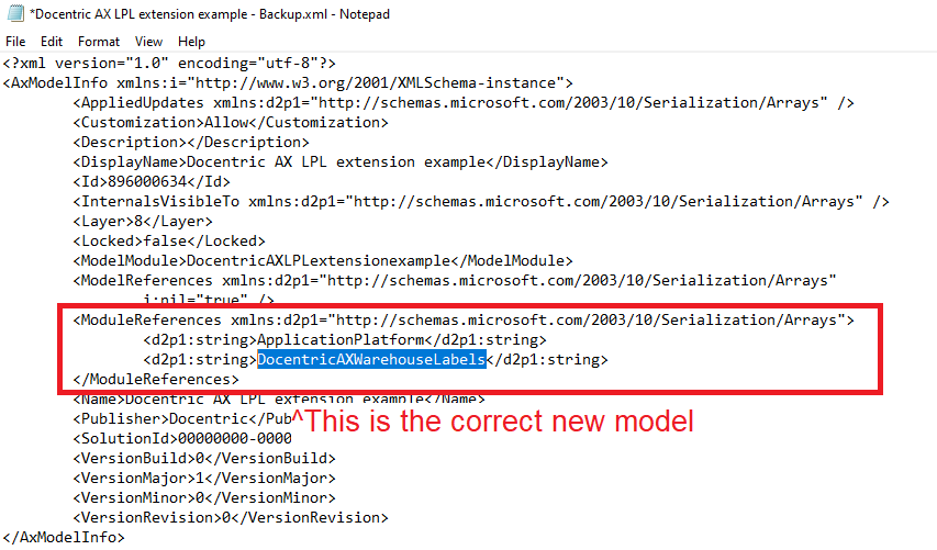

  1. Find and rename the descriptor file of the afflicted model(s), for example by adding the suffix " - Backup" :

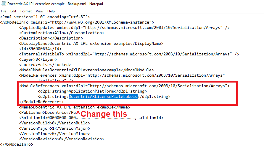

  2. Change the referenced model in the descriptor file of the model that is referencing the obsolete model:

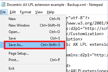

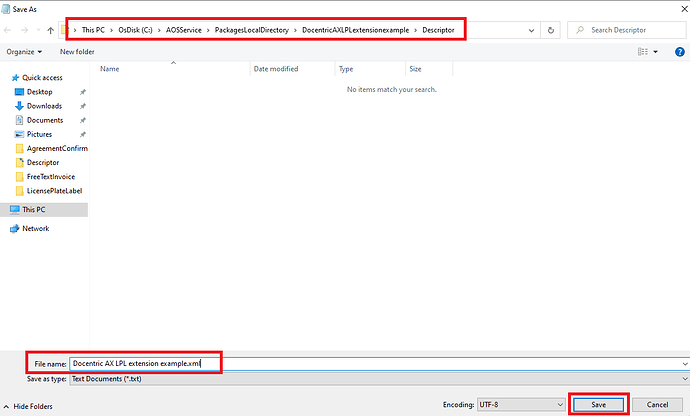

  3. Save the new descriptor file and name it as the original (without the " - Backup" suffix):

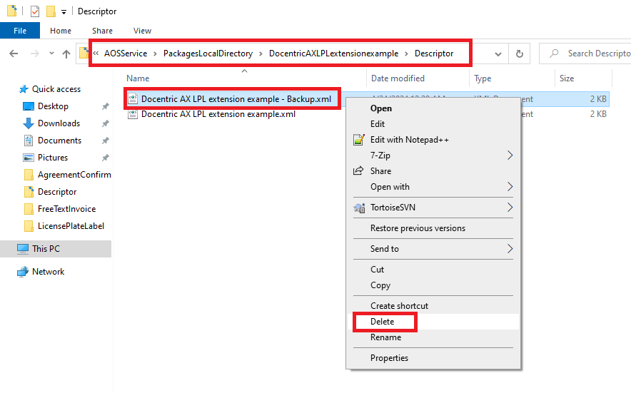

  4. Delete the old descriptor file (the one with the " - Backup" suffix):

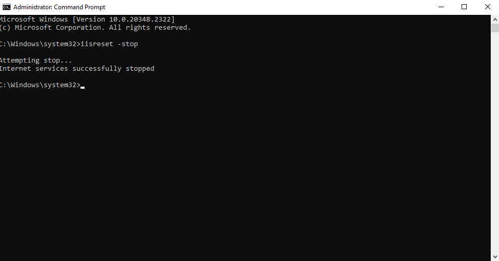

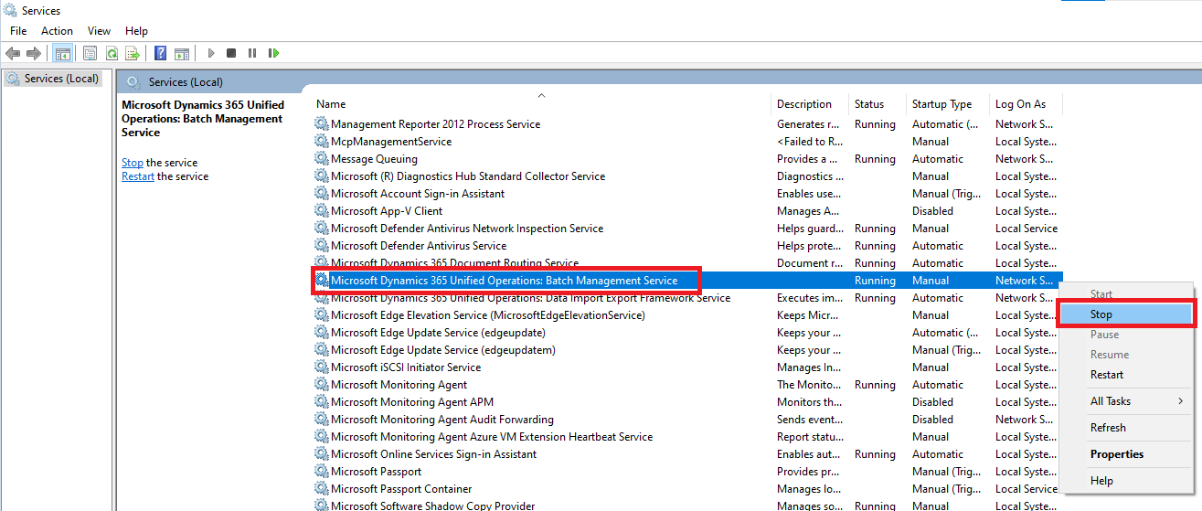

  1. Stop the IIS server and the Batch service:
iisreset -stop

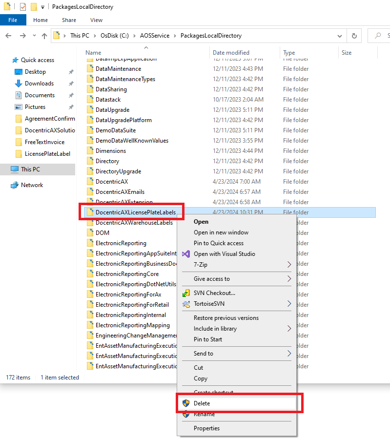

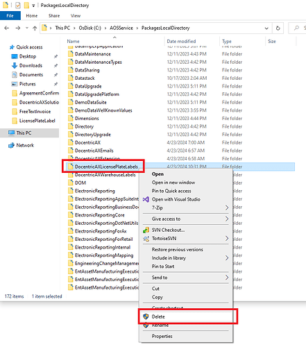

2. Delete the obsolete model from disk:

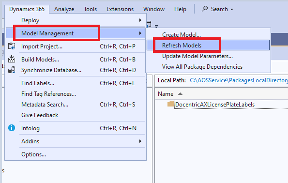

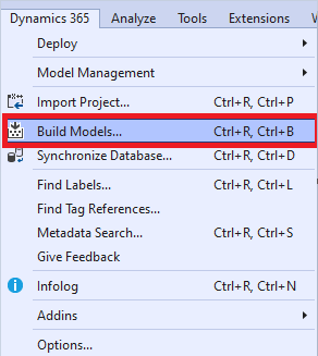

3. Refresh the models in Visual Studio:

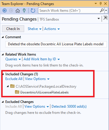

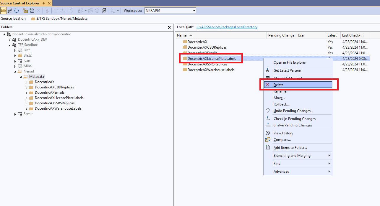

4. Delete and commit the deletion of the obsolete model to source control:

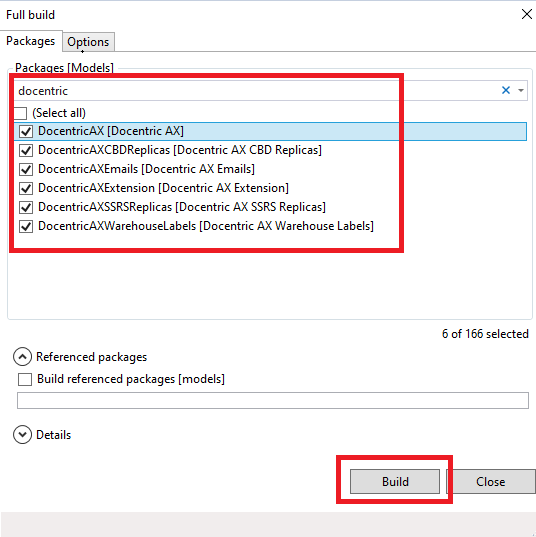

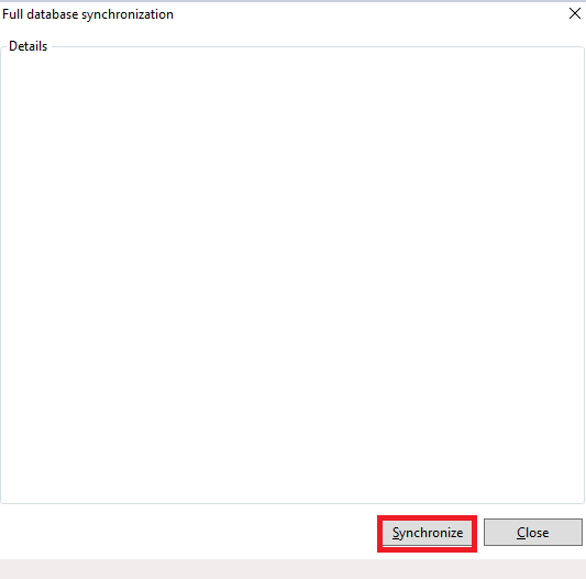

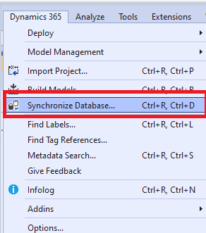

5. Build and Sync as usual.

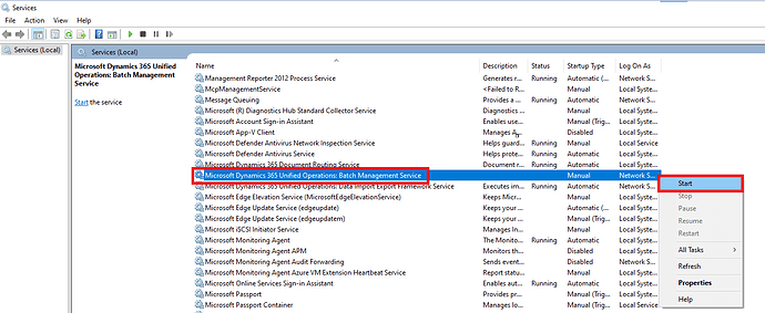

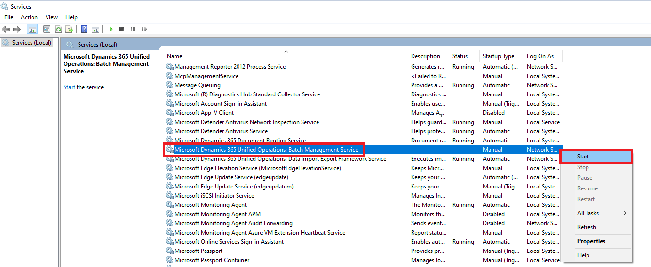

6. Start the IIS server and the Batch service:
iisreset -start

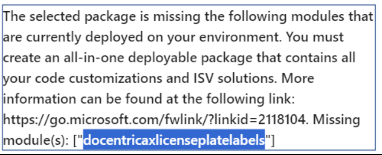

When uploading a deployable package you might get the following error message:
Transcript:
The selected package is missing the following modules that
are currently deployed on your environment. You must
create an all-in-one deployable package that contains all
your code customizations and ISV solutions. More
information can be found at the following link:
https://go.microsoft.com/fwlink/?linkid=2118104. Missing
module(s): [“docentricaxlicenseplatelabels”]

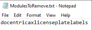

  1. Create a file that is named ModuleToRemove.txt.
  2. In the file, put the name of the module to remove, in this case docentricaxlicenseplatelabels.
