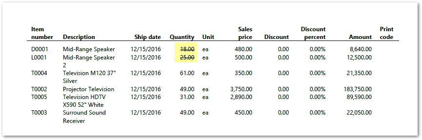

The end result looks like this (highlight is not part of the template formatting, I just added it to mark where the strike through is applied):

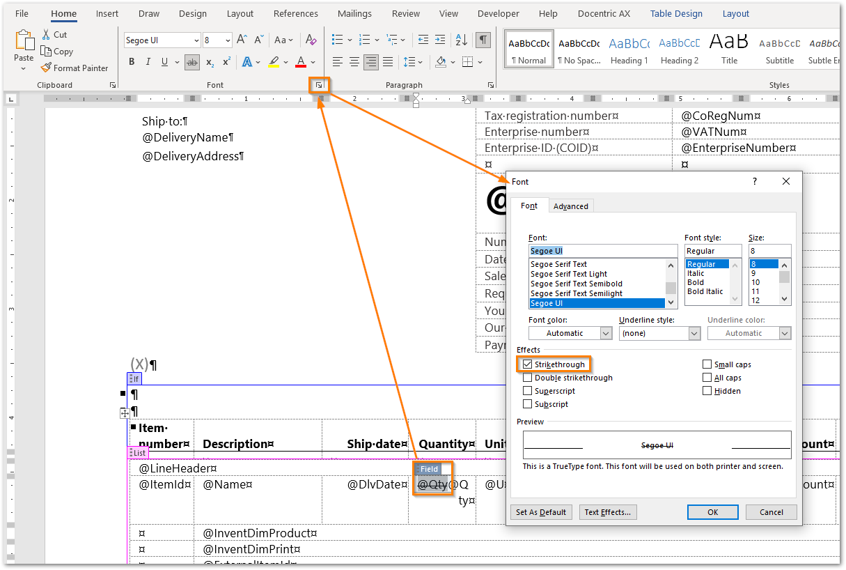

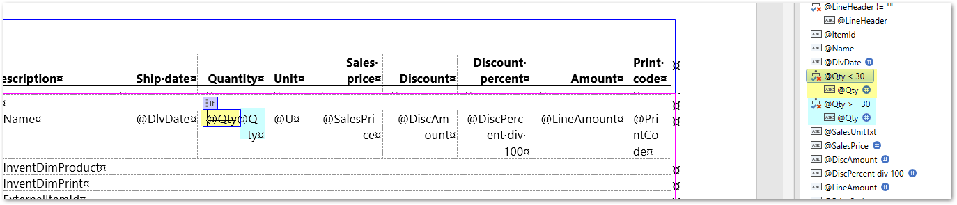

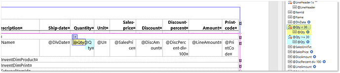

We cannot conditionally set just a strike through property, so we first need to enter Quantity field twice, one next to another, and the put each one of the under the IF tagging element, where we set expression when the IF tagging element returns true, in which case it’s content will be visible. This now means, that only one Quantity field will be shown and the other will be hidden. I also attached this template so you can download and open it and see how I implemented it.

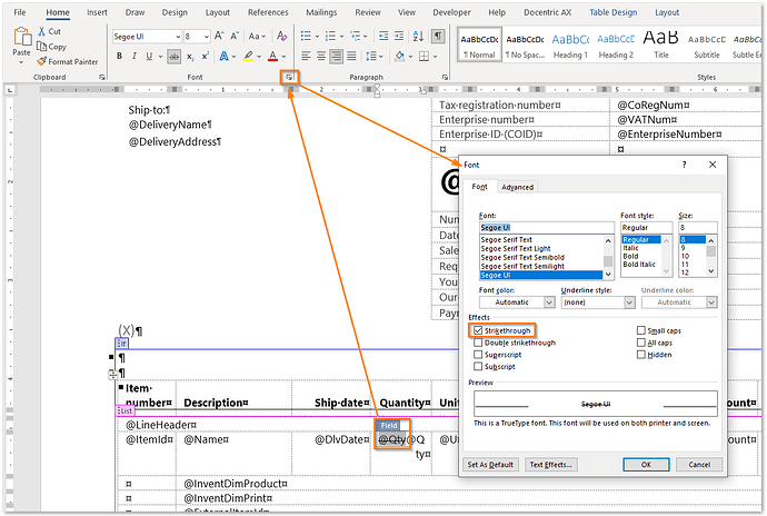

Now we need to apply the strike through on that Quantity field where this effect is needed.
Note that if you are using Live Preview, you will not see this effect, because Live Preview doesn’t support it yet. But if you preview it in Word or PDF, you will see the effect.
