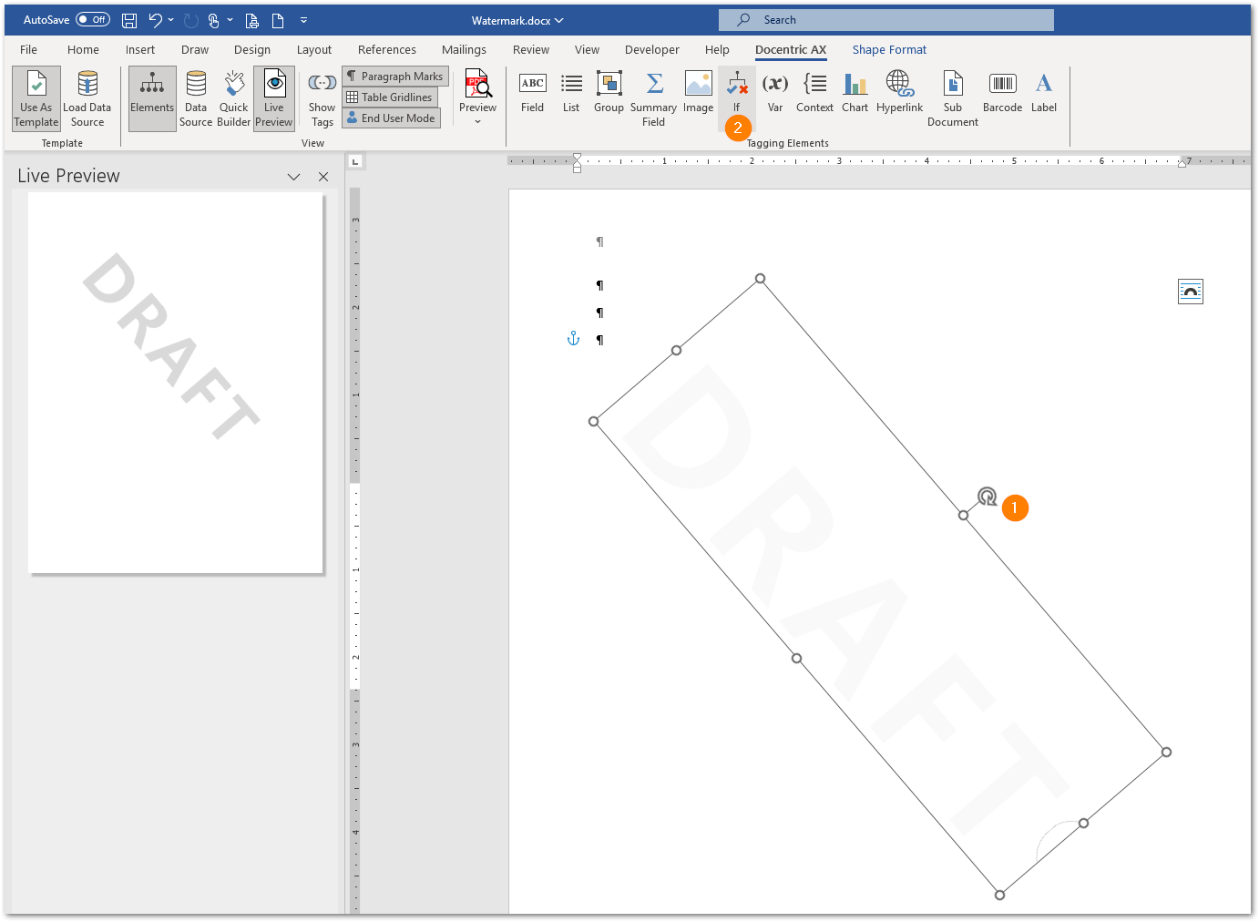

If you want to insert a watermark into the Docentric template, use the Text Box for it in Word. You can insert it on a page where you want it to appear. If you need the watermark on every page, insert it in a header.

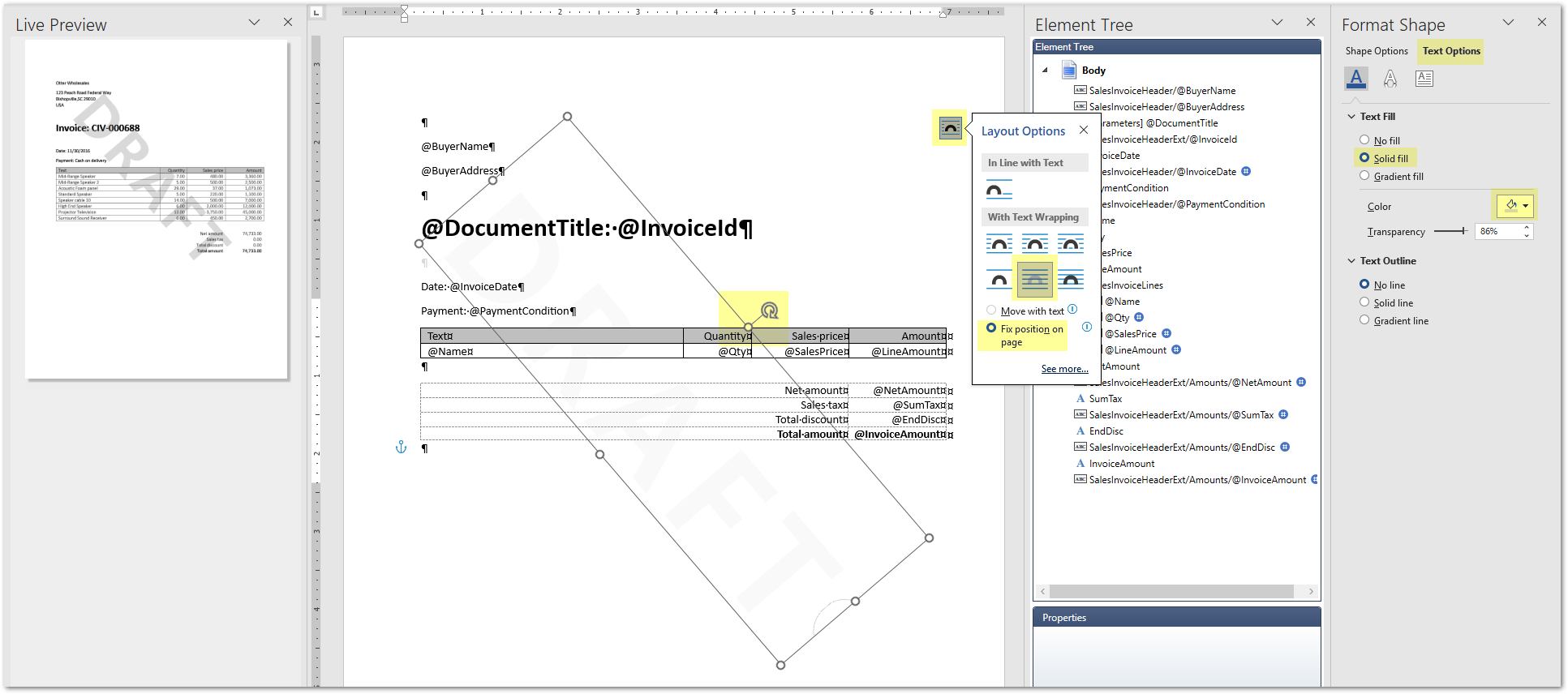

Then set the font size; usually 100-130 pt gives good results. Then you need to set the text wrapping and positioning. See the Layout Options pop-up menu in the center of the screenshot below.
You will also need to open the Format Shape dialog box and set Text Options as shown below.
These settings lead to the result that you can see in the Live Preview pane in the screenshot above. As you can see, the watermark looks quite good.
