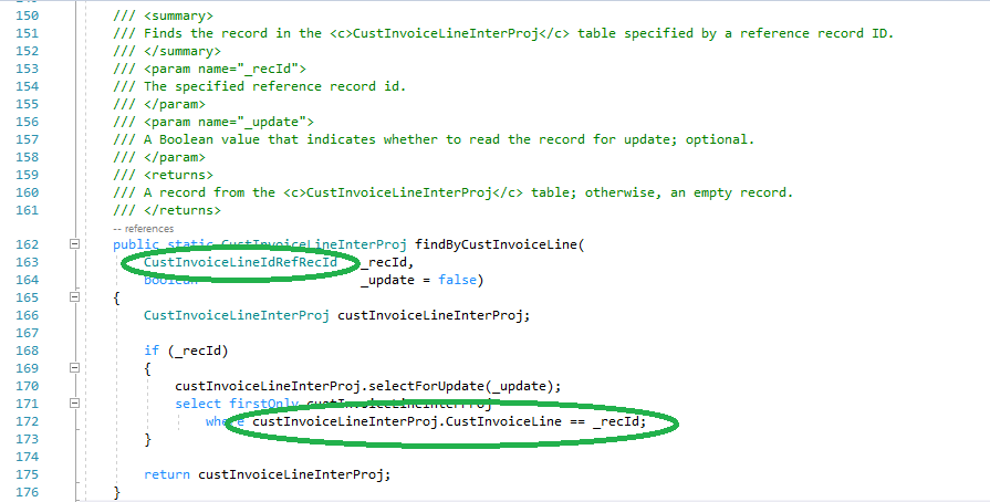

I think the problem here is just that the CustInvoiceLineInterProj::findByCustInvoiceLine() method is expecting the RecId of the CustInvoiceLine record which is associated with the CustInvoiceLineInterProj record.
There’s nothing Docentric specific about finding out the relations between tables. I’ll post some quick tips on how to do this, by using your use case as an example:
We first need to find out what relation we’re looking for. By going to the definition of the method, we can see that it is looking for a CustInvoiceLine RecId:

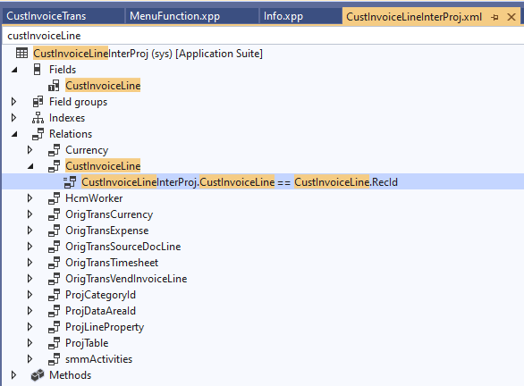

We can then go to the CustInvoiceLineInterProj table and search for the field, to find if there are any relations using that field:
Now we know that we need the RecId of the CustInvoiceLine, but the problem is that we don’t have the CustInvoiceLine.RecId when reading the FreeTextInvoiceTmp table, because the temporary table that’s used for printing has different RecIds than the original lines.
So here we need to find a way to get the CustInvoiceLine records, in this case you have already found the related CustInvoiceTrans record, so we can use that, by using the CustInvoiceTrans.SourceDocumentLine field.
