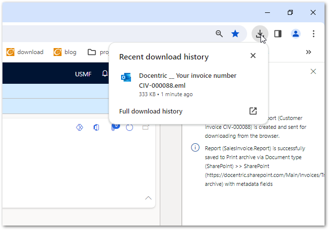

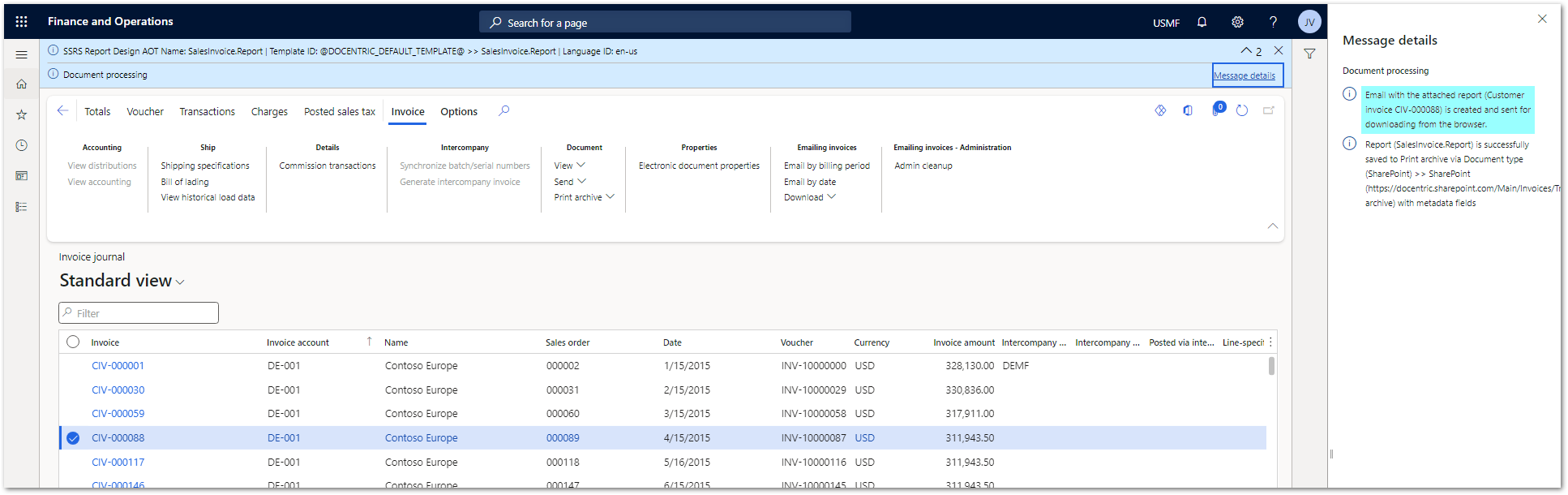

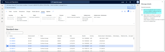

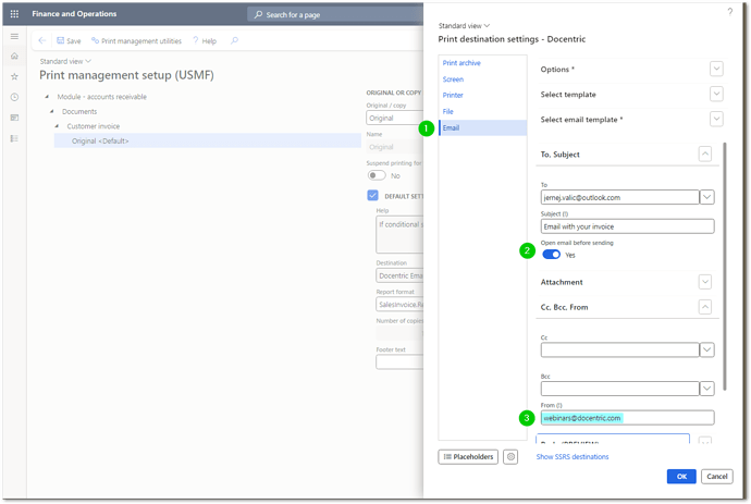

Docentric AX enables email generation from D365FO, allowing users to download emails (below, 2) for manual modifications or addition of attachments. The Docentric Email print destination also permits configuring the sender email address, including shared email addresses (3).
Expected Behavior
Users with necessary privileges expected seamless sending from Outlook when selecting the Download email before sending option, generating an EML file as the download format.

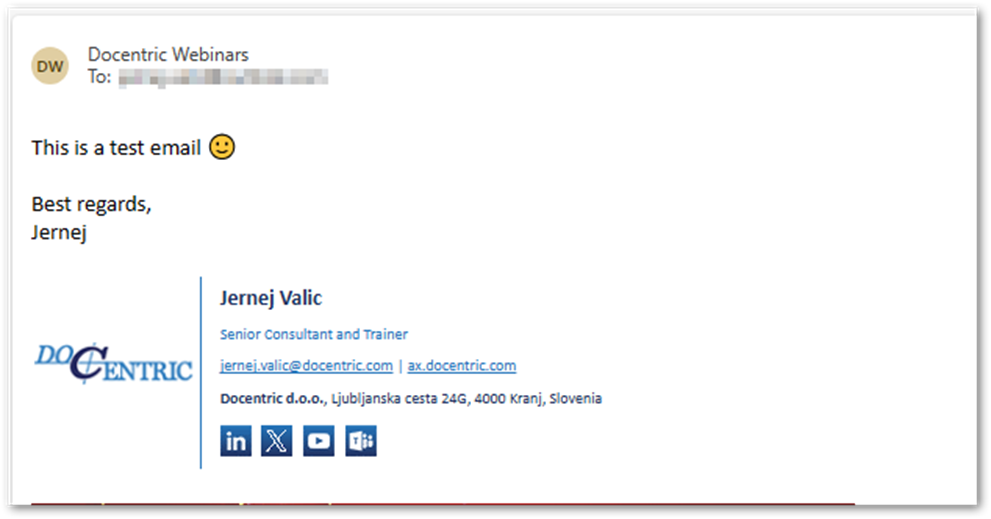

05 the generated EML file is ready to open

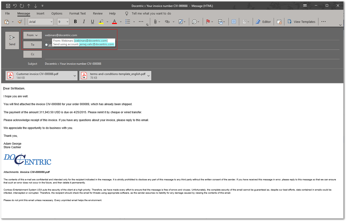

The EML file opened in Outlook is ready to be sent:

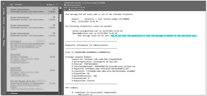

However, sending the downloaded email resulted in an undeliverable email.

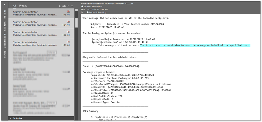

Reproduced: Undeliverable Email with Shared Email Address
Sending the generated email from Outlook using the shared email address resulted in an undeliverable message despite user privileges.
An example of the error message received from the email server:
Undeliverable: Docentric :: Your invoice number CIV-000088
Your message did not reach some or all of the intended recipients.
Subject: Docentric :: Your invoice number CIV-000088
Sent: 12/22/2023 11:46 AM
The following recipient(s) cannot be reached:
‘someone@outlook.com’ on 12/22/2023 11:46 AM
This message could not be sent. You do not have the permission to send the message on behalf of the specified user.
Diagnostic information for administrators:
Error is [0x80070005-0x000004dc-0x00000524]
Strange Error Despite User Privileges

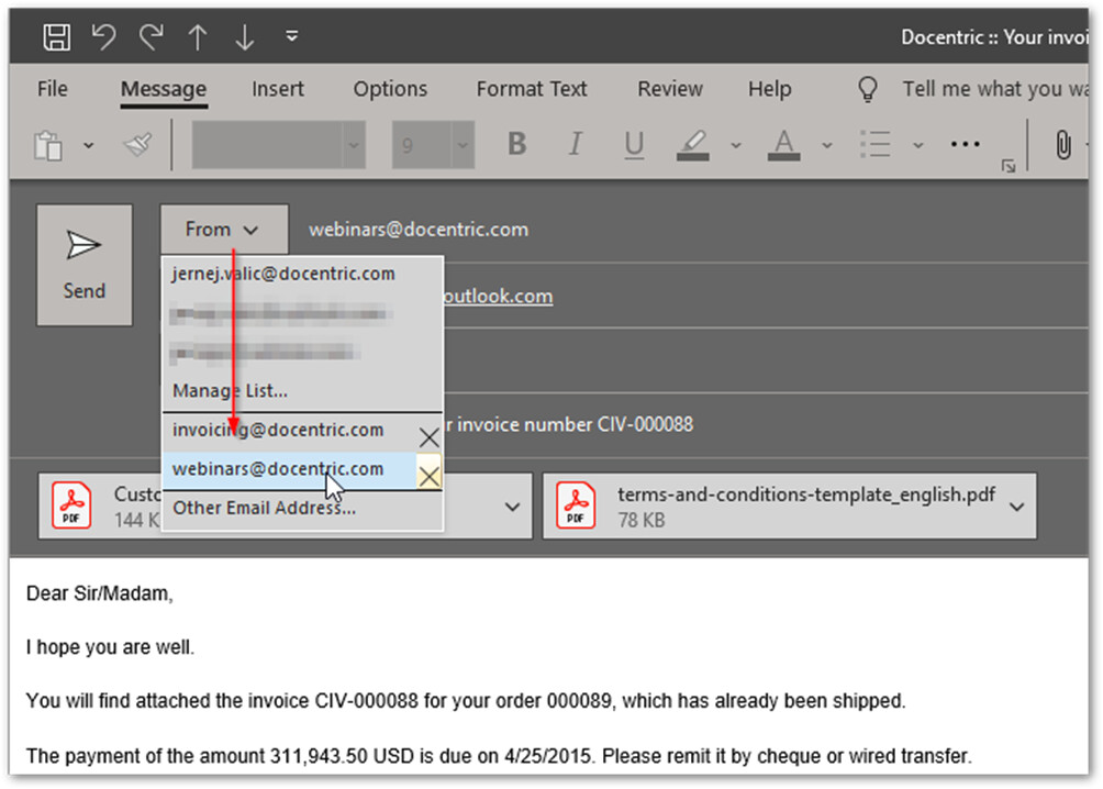

Solution Found: Reselecting Shared Email Account
After investigation, a solution was discovered. After opening the original EML file generated in D365, simply reselecting the same shared email account in the From field ensured successful email sending.
With this simple modification, we successfully sent the EML from Outlook using the selected shared email account.

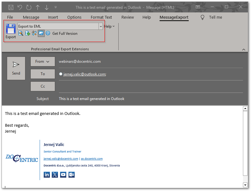

Testing the EML Message Created in Outlook
To prove that the behavior described above is not only related to emails generated by Docentric, we also tested sending an email created in Outlook using the same shared address. To do this, we first installed the MessageExport add-in for Outlook, which enables messages to be exported as EML files.
When opening and sending the saved email message - without modifying the sender address - we found the same result: an undeliverable email. However, reselecting the sender’s account has again solved the issue.
