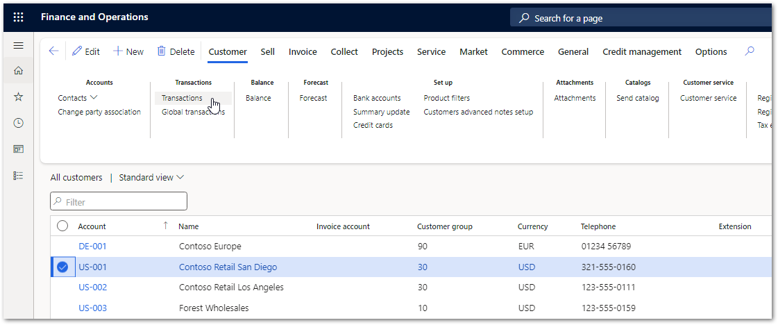

It seems that you are referring to the Customer transactions form under All Customers > Transactions.
To ensure clear communication in the future, could you please provide us with the exact steps to access the forms you refer to? Screenshots are also welcome, and you can paste them directly into the post :+1:
