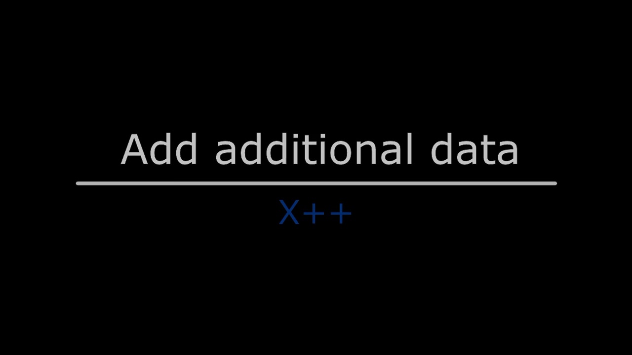

Hm. I’ll give it a try. I’ll remove the previous work I quoted above and try as you suggest. Is there a simple Docentric page that talks about this?
EDIT: Is this the related youtube video that shows how to do this? This one is 5 yr old and AX looks very different, is there an updated version of this that I can find on your YouTube channel?
I’ll report back with my progress.
Hi Jim,
There’s a blog article on the topic of creating a new custom report using Docentric, which has a chapter that uses the addCalculatedField() to add data from a table buffer.
Here’s the link to the article, the code in question is under “Step 3: Create a custom DSP class”.
In regards to the video you’ve found, AX may have changed, but the only thing that changed regarding the code you need to type is that the editor is now Visual Studio and not MorphX.
