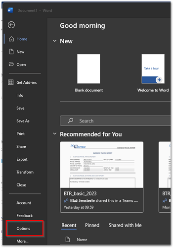

- In Word, navigate to File, and then select Options:

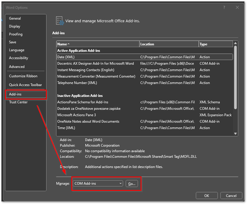

- In the Options window, access the Plugins section, and under the “Manage” dropdown, select “COM Add-ins.” Click the “Go” button to proceed:

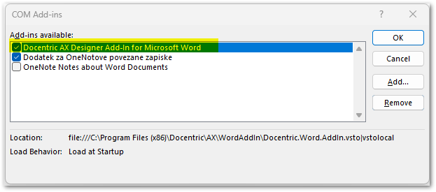

- Ensure that the Docentric AX Designer Add-In for Microsoft Word is chosen, and confirm that the checkbox is marked. Click OK to proceed.
Close Word, open it again, and see if the Docentric AX menu is back. If it is, great job – you fixed it!

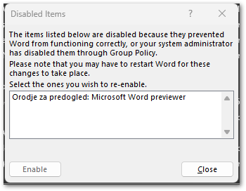

- In Word, go to File, choose Options, click on Add-ins, select Disabled items, and hit Go.
- A window will appear, showing hard-disabled Add-ins. If you find Docentric AX Designer, click on it, and select Enable.
Close Word, reopen it, and check for the Docentric AX menu. If it’s there, congratulations – you’ve successfully activated it!
