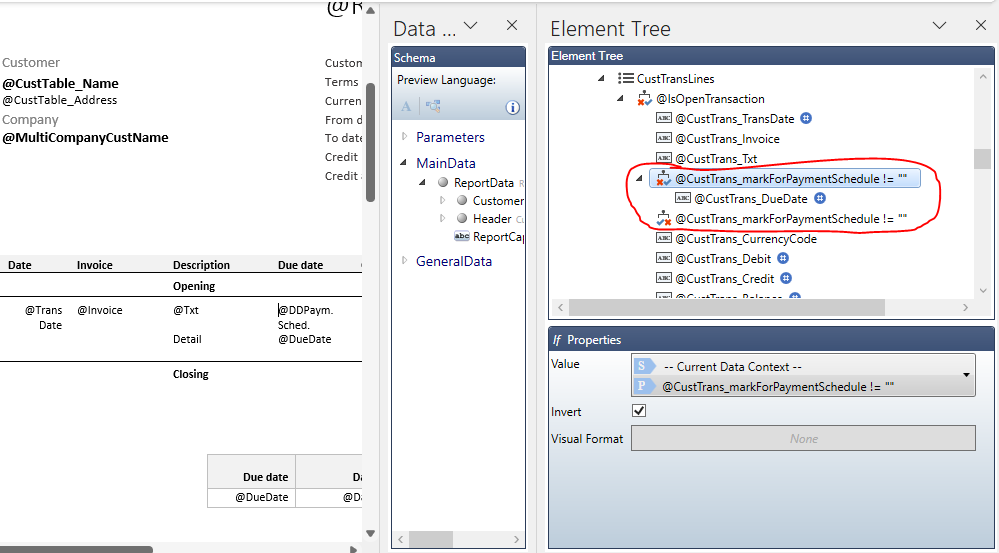

Hello Blaž, thanks so much for your quick reply and explanations of the expressions; I will take some time to understand and work with them. For now my remaining question is where can we see the full expressions? Example:
Where can we access or edit the full expression?:
iif(@CustTrans_markForPaymentSchedule != “” and data-source(‘Parameters’)/@PrintPaymentSchedule = “false”, “true”, “false”)
Or is it only “behind the scenes” after being inserted using the If tagging element?
I am guessing that you might not have the latest SSRS replica template installed as the expressions I’ve mentioned are located over the @CustTrans_DueDate field and “Paym. Sched.” label.
Hi again Blaž, the templates we were using were loaded Aug 2022 (3.4.4 I believe). I just opened the one from the link (3.4.6.2) and still see the same items in the Element Tree as before, not like your screenshot. Do we need an updated Docentric Word add-in?
Hi David, I do apologize, this is already a new version of the document which will be released in the following days, so it’s just around the corner.
