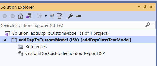

For example, here we have created a new solution addDspToCustomModel, a new project also called addDspToCustomModel and model called addDspClassTest . It has references to DocentricAX, DocentricAXSSRSReplicas, ApplicationSuite, ApplicationFoundation and ApplicationPlatform.
The class CustomDocCustCollectionJourReportDSP in the project has the following sample code:

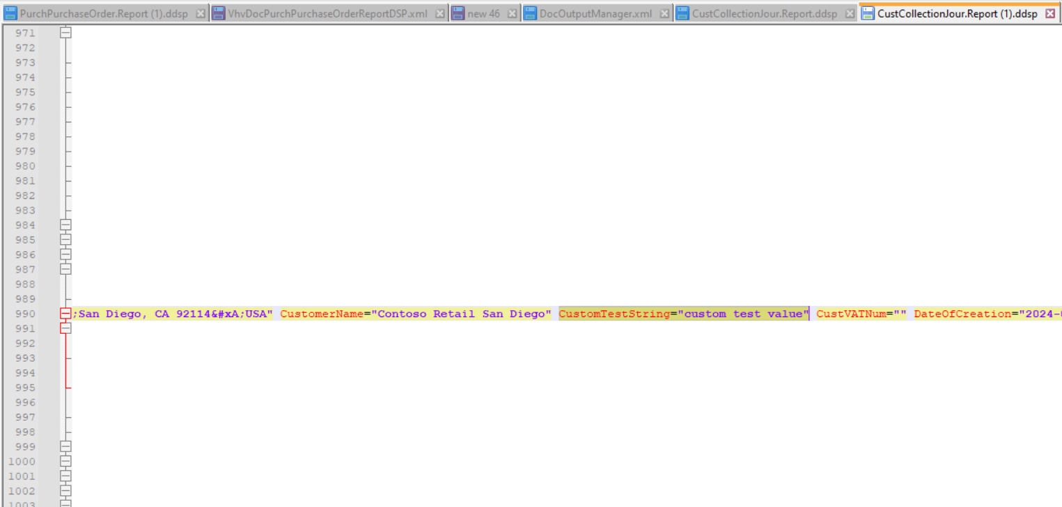

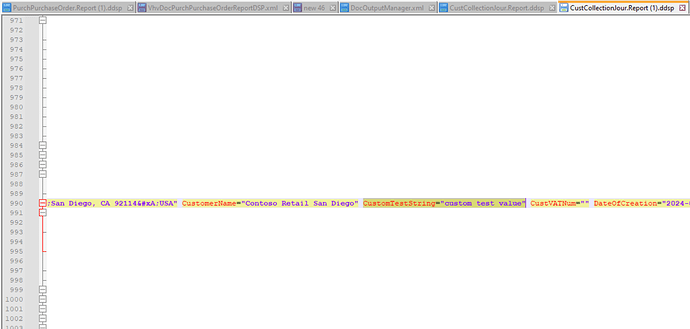

- New data is added to the CollectionLetterHeader record:
