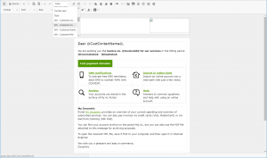

When you open the Print destination settings form and choose Docentric Email print destination, you will notice the rich HTML editor that you can use to design your emails in terms of styles and formatting. There is also a dropdown list: Fields that contain all available placeholders you can use in the email body as well as in all other print destination settings such as the email subject, attachment name, blob path, output filename, etc. Using placeholders you will make your emails dynamic.
There are many placeholders supported out-of-the-box for all reports such as @REPORTCAPTION@, @COMPANYNAME@, @COMPANYLOGO@, @WORKERNAME@, @WORKERIMAGE@, etc. These are called standard placeholders. Moreover, each report can have additional custom placeholders, e.g. @InvoiceId@, @SalesId@, @InvoiceAccount@ or @CustContactName@ for the Customer invoice report.
Besides this classification, placeholders differ by the type of the content they get replaced with. Docentric supports two kind: text and image placeholders. Text placeholders are replaced with text (e.g. Invoice ID), while image placeholders are replaced with images (e.g. Company logo).
As we said before, you can add any placeholder to the email body by selecting it from the Fields drop down list. Custom placeholders usually have a prefix, e.g. INV for Customer invoice. Text placeholders are inserted as @Placeholder@, while image placeholders are inserted as blank pictures.

With Docentric’s powerful email editor you can use not only company logo when emailing reports but you can easily achieve a very professional look of your emails. Below is a real-world example of an emailed invoice and how to design it.
